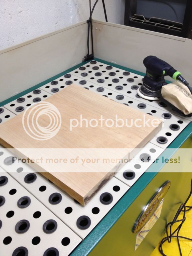

I have this grizzly downdraft table and love it. It's not a small unit by any means, but it virtually eliminates most of the problems I've had with sanding dust. I'm sure a smaller version would do the same.
