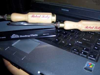

Here are a couple of my favorite chisels.. I got them at the local Woodcraft store... paid about $45 each for them. One is a 1/4 inch and the other is a 1/2 inch. Robert Sorby made in Sheffield England.
Also shown is my honing system made by Veritas with a Pinnacle Honing plate. This system will sharpen so good that you can literally see yourself in the bevel of the chisel..... wicked sharp.
