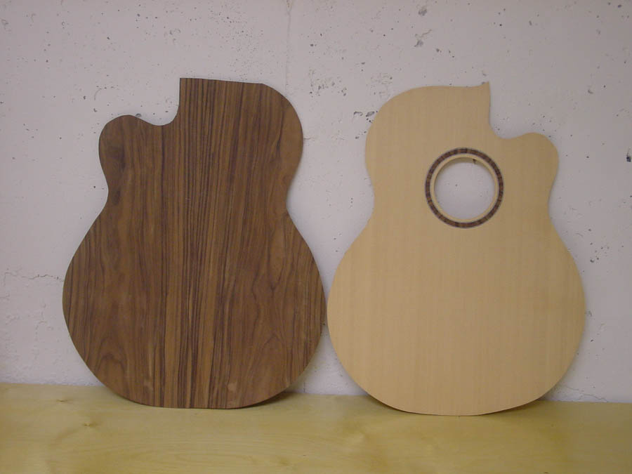

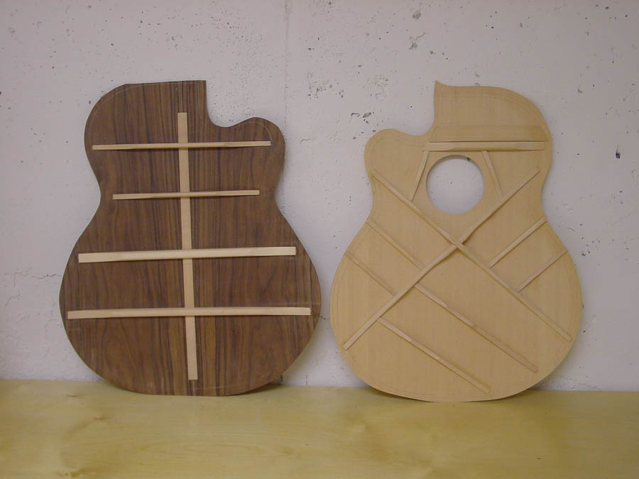

I’ve been planning my next build, and wondering about the several possibilities in choices of wood.
I got this pre-braced top and back set at the swap meet, and I thought why not finish her up.
I thought at first, the obvious choice for the sides should be the same species as the back, which is
Pau Ferro. Lately though, I’ve been thinking of maybe trying something different. For instance, if
I use a mahogany neck, would mahogany sides be complementary? Also, for something really
different, I’ve got a set of bubinga sides, that would be quite the contrast. I suppose that if I go
that route, it would require a very carefully selected appointment scheme.
I would very much like to hear from anyone who has an opinion about this!
The following pics are the set in question, maybe it’ll help.
Robert
Thanks for Looking!

Hesh, I do like the idea of using mahogany. But, the more I thought about it, the more I wanted
to try something new! So, here’s another pic showing mahogany, & bubinga against the pau ferro.

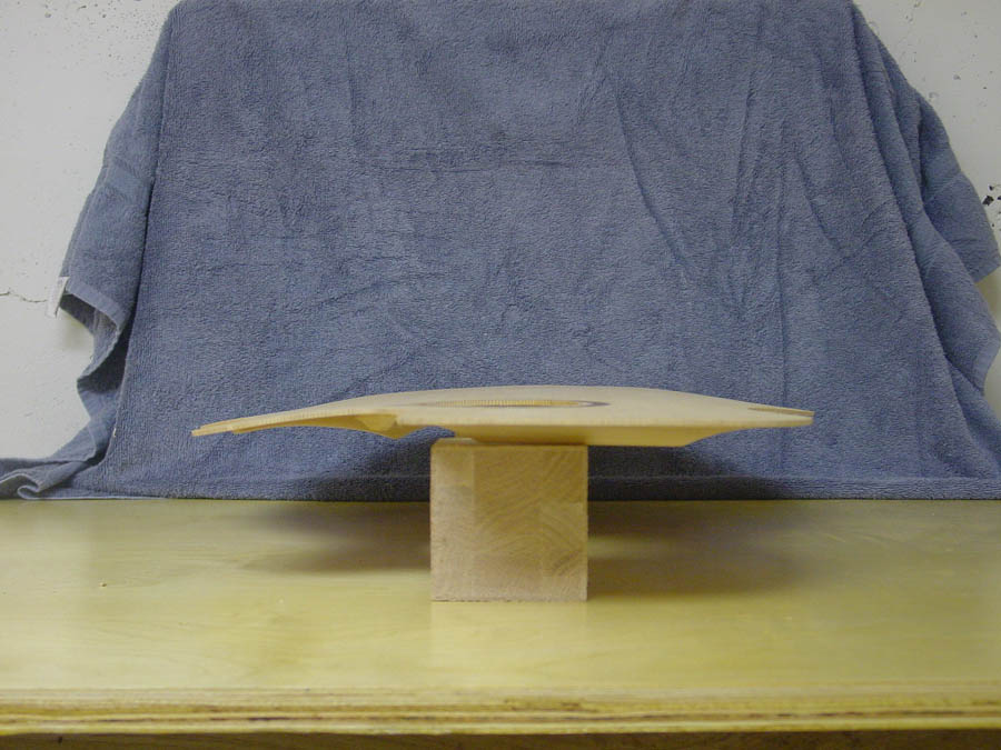

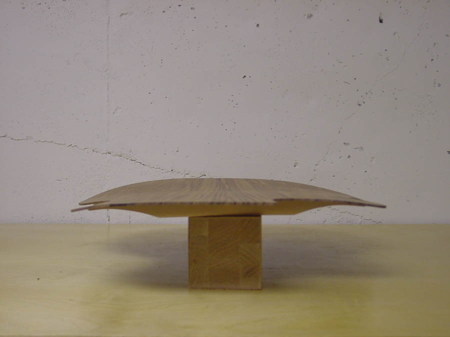

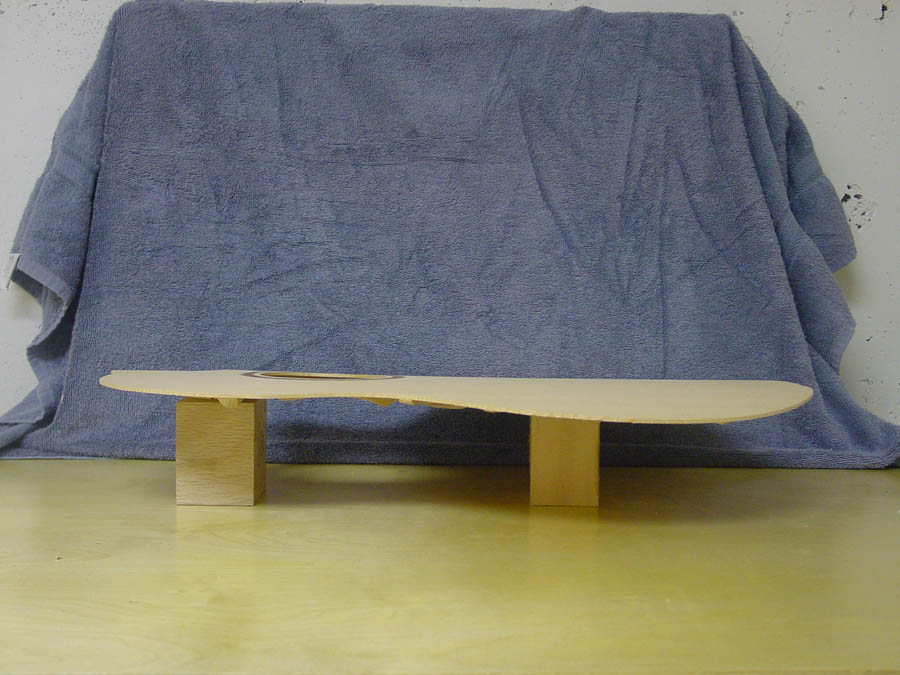

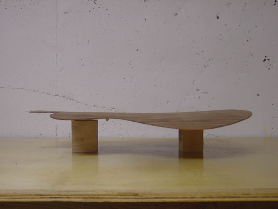

Also, it has been mentioned, the possibility of losing the dome. Here are some pics that show the
condition of the back & top.
I would welcome more comments on the following pics as well.

PostPosted: Fri Jul 06, 2007 10:45 pm
Wow. Someone has humidity control issues...
What does your shop humidity measure out at?
Looks to me you're going to have to pull off all those braces, get the wood flat again, and re-brace after you get a rim made to put them on.
