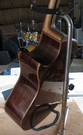

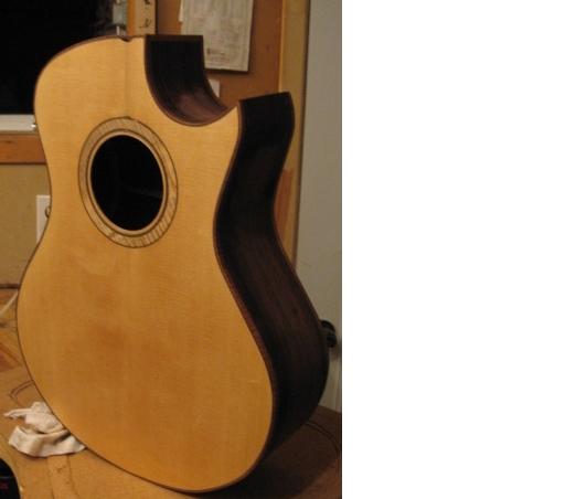

Okay, since I haven't posted in such a long time, here are some update shots of no.3...
Sitka.

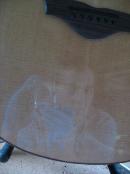

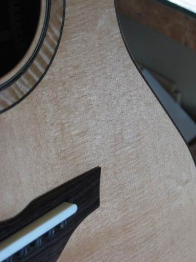

Now, the sad part is that I wasn't vigilant enough on the pore filling (I wasn't happy with some of the pores showing) and since these pictures were taken, she was stripped back to the wood and I've started over again... (back and sides)

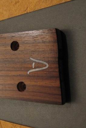

On this one, I wanted a headstock logo. So I drew this up and Paul Bordeaux cut them up for me! (This picture was taken just after inlaying, prior to pore filling and finishing) It's a stylized A or D, depending on the angle you look at it... Luckily for me, those are my initials! Ha!

Hey Alain! Haven't seen you here in awhile.Sorry about your finish problem but you will get it fixed I know.I did the same thing on my first finish!I managed to fill all the pores with a couple more coats.Not too bad. Cool Logo too! I like how it can be an A or a D !

Looks like some good miter work at the cutaway... nice one!

Dave, this was/is my first attempt at nitro! I love the stuff! I used Mohawk's and I couldn't say enough great things about it! I was thinking that nitro is a good 'pore filler' so I skimped out on the epoxy, giving her just one round... Big mistake! Nitro might fill in minor scratches and whatnot, but it's no substitute for proper pore-filling! Live and learn... In was really too bad, because the finish came out a lot better than I had hoped for...
Christian, I'm at work now but I do have much better photos of the mittering. This was the one spot where I wanted to improve and I'm very happy with the way things turned out!

What is the rosette made of? Looks like maple.
Do you build in a solid block at the tip of the cutaway?

You are absolutely right. The rosette is curly maple. I did put in a solid piece of mahogany at the tip. I joined the tip with HHG and then I fashioned a triangular mahogany block to fit the point. I used the sides themselves as the sanding caul. The resulting piece had an air-tight fit! I just pressed that into place and I used HHG and voila! That tip is probably the strongest and most resilient part of the whole guitar... I have a tonne of pics. If you're interested, I'll post them tonight.

Wow!  I don't know if it is the lighting in the photo, or how the colors show on my monitor but that third picture (from the back in the stand) is stunning to my eye.  I absolutely love the platinum color of the neck and bindings.  Again, it could be how my monitor is displaying the color but it is a very unusual color which I really like a lot.
Beautiful guitar!

Steve, thank you very much... The problem is that I couldn't stand to look at it anymore! Had I planned to finish with pores there would have been no problem. However, this was far from my intention. I wanted a smooth, mirror-like finish. I had worked so hard and struggled through many 'firsts' (florentine, head stock inlay, neck laminations...) that I just couldn't accept the pores. I just couldn't imagine showing her off to anyone and having to say (or hear) something like, 'Yeah, she's all right, but it's too bad about the finish...'
At any rate, after sanding back to the wood I have a very good idea how much I had on there, plus, I've a new found appreciation for nitro's tenacity and durability! I found it extremelly resilient!
