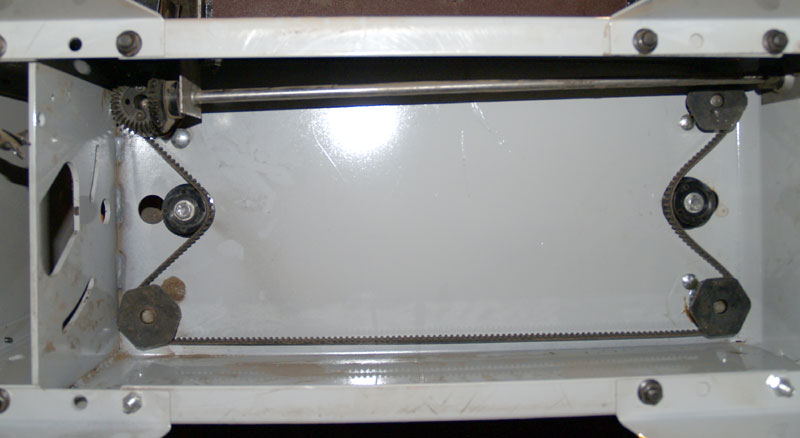

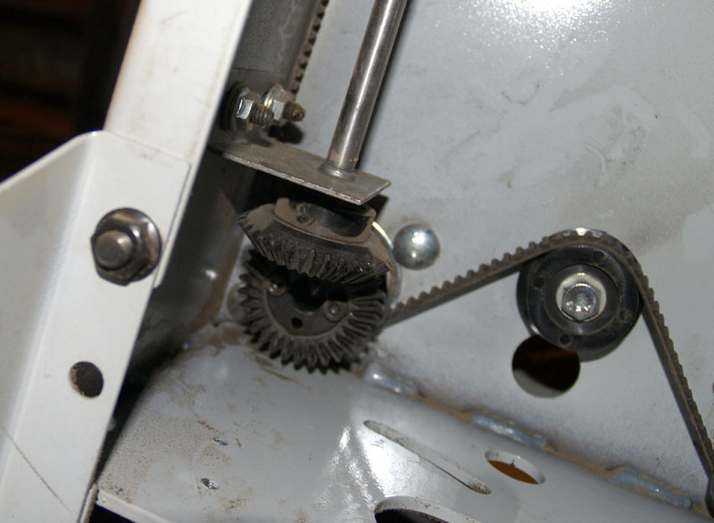

After 5 years of use, my sander's four screws were out of alignment so badly front to back that the height adjustment was too tight to function properly.
If I had these pics before I pulled the motor I probably could have gotten the timing belt off and back on without this much dismantling. So, if your sander is at that 'rebuild' point, maybe this will help.
John Watkins

I have the Delta #31-250. One of it's known issues: if you turn the handwheel that adjusts the feed table height too quickly, the serrated timing belt will "skip a toothe" on the gear. I successfully adjusted it from the top using the instructions in the manual. Further prevention includes slowing down my "cranking speed" on the handwheel
I'm not sure if I'm getting why your motor was removed. I'm curious to know what exactly was wrong and how you fixed it John. I know my machine is quite problematic, and I could use all the help I can get. I think the #31-255 might have some improvements.
Thanks for posting. I'd like to keep this machine till I have a doorway that is wide enough to accomodate a 25" dual drum!
Thanks for your patience John. Just not sure if I'm getting it....

I have a bad gear on mine right now, but it's because, after 4 years of use,
the silica packet that was in it, that I never found, finally decided to jiggle
loose, get caught in the gears, and chew em up. (man that was either a
really bad run on sentence or a nice long one)

Seemed perfectly formed to me, albeit, lengthy.  Sounds like the gears must be pretty soft if they were ruined by a silica-gel packet.  I guess it's hard to find things that are over-engineered these days.

I got mine with a seemingly very stretched belt on one side. To track properly, the belt is snug on the right side, and loose on the left. I thought of replacing the belt, to see if that's the case, or if something else is awry.
When I initially got mine, I also adjusted the tension on the timing belt  idler rollers to make the handwheel turn easier. Too loose and it'll "skip a tooth" A finicky machine for sure. I most recently took some vibration out of the machine. I did that by loosening and retightening the 4 drum bearing bolts. It runs measurably smoother. There was about .045" vibration, now it's about .012", between the feed table and the drum frame. It SOUNDS much smoother too.
