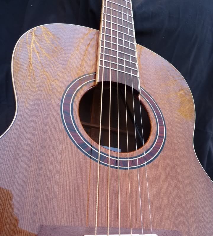

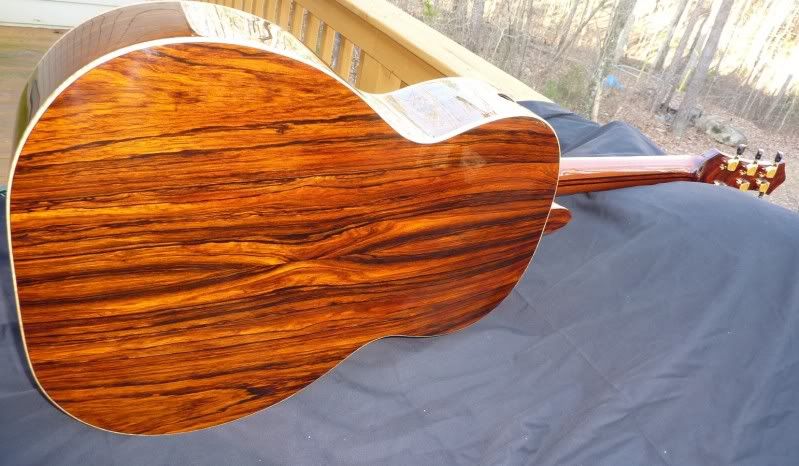

Well, here is the latest to leave my shop....it is a 000-13 fret, Sinker Redwood/Cocobolo.

Wow, what a beautiful finish too, not a flaw!

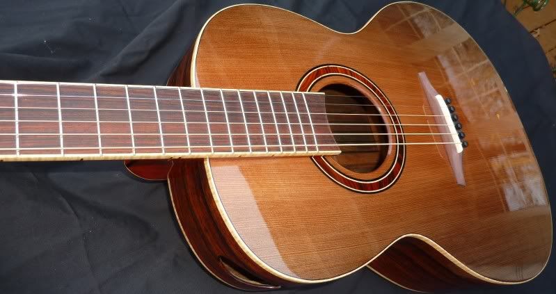

Wow, what a beatiful guitar. Congratulations! The finish looks stunning indeed...
Is that binding Curly Maple?
+1
Upper & lower upper-bout ports...hmm... shag rug or hardwood flooring make for a different sound!?.
Seems to me projection towards headstock might really gain as they look to be slightly forward?
Top cylindrical arched rather than domed or is it my eyes being goofy?
I have to admit Wanting to know/see all the details.
solid or kerfed liners
neck construction and attach..
side depth
sound hole size
ports size
top bracing
etc....
IN progress pics....
in other-words as much as you feel like sharing....
In any case Swish.... nuthin but net!!!

Totally gorgeous bro'! :shock: No backstrip on that coco was a perfect decision - one big swirly mass of yummyness.

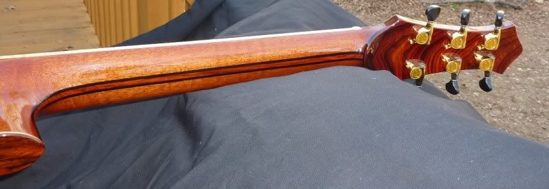

what wood did you put on the back of the head stock?

Hi all, and thanks for the kudos.
Quote:
Make me one like that next time you in the shop.
I hear ya Padma, I'll put you on the list right behind me, should be 20 years or so laughing6-hehe
Quote:
The finish looks stunning indeed...Is that binding Curly Maple?
Joe White finished the guitar, it is curly maple binding.
Quote:
Upper & lower upper-bout ports...hmm... shag rug or hardwood flooring make for a different sound!?.Seems to me projection towards headstock might really gain as they look to be slightly forward?
Ah, a little experiment I did with a dummy guitar led me to use dual ports in these locations..YMMV
Not cylindrical, though I'm looking into it..... I use unusual arching to accommodate the elevated fretboard, just seems to work for me.
I understand, though I've got to keep some things secret :D
Kerfed, though I'm going to solid soon.
Bolt on, elevated fretboard
Quote:
side depth
Approximately 4 5/8 tail block & 3 5/8 neck block
Quote:
Sound Hole Size
4"
Quote:
Port Size
Not sure, I've got it set on my computer, just print it and cut now
Quote:
Top bracing
Ah, now see we arrived at a secret again bliss ,Lots of experimentation, I've gone my own direction here, no big deal but it is different than traditional bracing
Cocobolo front & back of headstock, a couple of cool pieces I collected for a guitar like this.

I think your wide maple (?) bands in the rosette are perfect compliments to the maple binding. Simple touch that ties things together nicely.
Thanks Steve, yes, it is maple.

Yo, dude,
in 20yrs, me most likely gonna be dead so me just stopped in for another look at her.
Looks like a mahog neck with red wood up the center and coco caps ... Yes?
