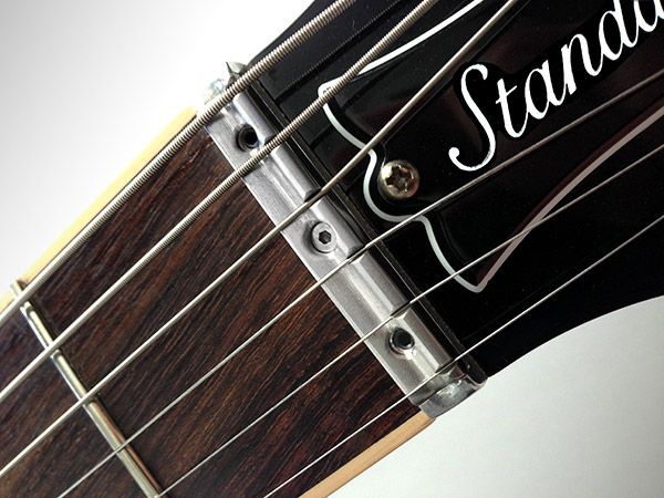

Thoughts?

We got a call from the family that has taken over this product and has an effort, actively to promote it. It's been around a long time likely under a different distributor and when we took over our shop we had three of them in an old drawer. We still have three of them....
They wanted to send me samples and as usual I pushed back.... They wanted endorsees and of course I pushed back even harder. We are not a store and the very idea of selling a one size fits all you don't have to know what you are doing music store hack solution is not something that we are interested in.
Me... I'm not opinionated...;)
As for thoughts it's the kind of thing that someone comes up with who does not understand how a guitar, when properly set-up works.
When the nut slots are cut optimally and the nut is well made there is no need for anything like this. I can't remember if there are any mods to the end of the fret board but I think that there probably weren't. If this is the case, no invasive mods I don't see any harm in it but I also don't see any benefit what so ever. In fact with conventional methods and a conventional nut we can have more control over individual string nut slot depth over the zero fret.
In short - a solution looking for a problem.

I wanted to add that in my experience acoustic guitar fans are very loyal to tradition..... Reminds me of Fiddler On the Roof but I digress...
True there have been zero frets in history and on vintage instruments as well but this kind of a mod is likely the kind of thing that most traditionalists will turn up their nose at. Include me in that bunch too.

I'm with Hesh, it's a solution looking for a problem.

+1 Heshtone. Also, the great thing about zero fret is that you level it with the other frets and ta-da; it's the exact right height. I don't know how you would just drop this in and be anywhere near the exact right height.

$30 to put lipstick on a pig.

http://www.gibson.com/News-Lifestyle/Ge ... e-Nut.aspx

The Gibson nut has an actually advantage, in that it is capable of being precisely adjusted. Of course the detail of this adjustment is still confined by set radius, which means its potential will still be limited to beneath the standards of a well cut traditional nut, but it's not a bad idea. At the very least, it may allow people with less skill to get better results with lower risk, even if not quite as perfect as a skilled tech can cut a bone nut.
The Zero Glide though, it really brings nothing. Not only is it a solution in search of a problem, but it brings problems of its own and does little to solve those that were already there.

I don't see the point in it, especially for builders when you could just as easily install a zero fret. The only redeeming quality I can see in this is that the open strings will have the same tone as the fretted ones. But even that is suspect since it's not a fret well seated into the fretboard. I do like zero frets actually.

I'm not really looking forward to working on the Gibson contraption.
Even if they can manufacture them to provide a perfect string bottom radius, they will have to make an equally accurate fretboard radius to match. That's not something a lot of manufacturers have had success with.
By the time the mill marks are sanded out, the boards tend to be all over the place. Rounded over edges etc. That puts them right back where they started, hand adjusting string heights or sending them out the door goofy.
I'd be willing to bet the first one I see I'm going to want to even up the string heights. The Titainium I've worked is pretty brutal stuff too.
I don't want to be a kneejerk naysayer of new things but my confidence is pretty low they'll bring it all together for an improvement.
Just putting the adjustment screws on a more conventional nut makes more sense to me if adjustability is the goal. But I have a feeling finding your .050" Allen wrench and jacking up your nut a few times to play slide might quickly have you shopping for a better way.
