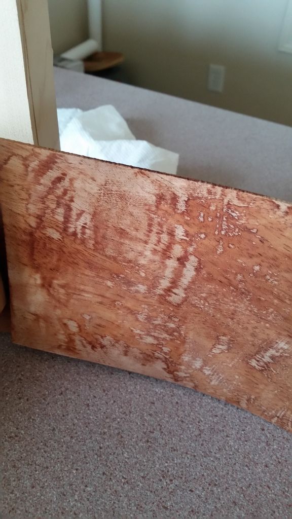

I'm here to learn. I sprayed a heavy layer of SS2 on both sides of my Maroke set. I let it set for 12 hrs per instructions, wrapped in paper towels. It was dry when I tried to bend it on my hot pipe and I noticed no difference to my poor results with a wet shop towel slowly steaming on the pipe on my first attempt. In both cases, despite extreme caution, the sides cracked across the grain. I've never worked with Maroke before, and it did seem very stiff and resistant to bending. Admittedly I am trying to bend a very tight curve on a 00-28 build, which certainly contributed to the problems. Even after I had it successfully clamped in a mold overnight the sides cracked in multiple places. Totally ruined both pieces. Where did I go wrong?
How thick were the blanks?
Note that Martin thins their blanks to .078" -- So do we (KMG), like us Blues Creek bends many sets each month, in another current thread John Hall mentions that he is comfortable at .070"

I went with .80, a bit thick I suppose. This was highly " mottled ", very dense and stiff wood. I also have no temperature control other than how wet I keep the shop towels. Has worked well till the Maroke set.
