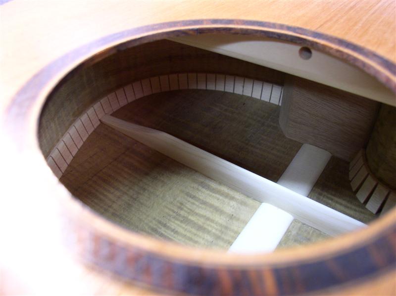

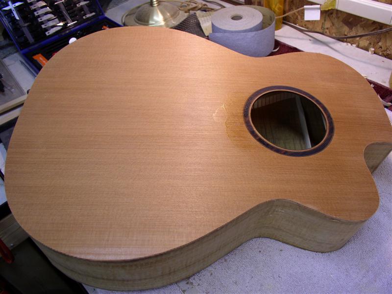

Here is an update on one of the guitars I am taking to Miami and Montreal.
I just closed it up today.
Its my first using Redwood and Koa together.
Thanks for looking!

Looks nice Lance. How was bending the Koa for the cutaway?
PostPosted: Sat Jan 12, 2008 1:44 pm
Thanks Anthony, I used supersoft II and it worked fine. I was sweating, but all for nothing

Nice Lance. Hey, you're using regular, triangle liners here? Is this because it's a smaller guitar or...?
Is that BRW rosette? what you going to use for binding, fb and bridge? BRW?

You big tease! give us a shot of the Koa!! Koa! Koa! KOA!!!

Very nice Lance - that combo - Koa/Redwood should make a killer guitar.
Remember to get us from pics from South Beach - of the guitar too....
