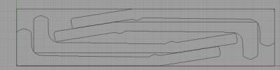

Waste is always a factor in woodworking, I suppose. Every time I've tried to set up a process to be as material-economical as possible it has cost me dearly in time, though. Your constraints may differ, of course. I set up my laminates like this:
That gives about 35% waste. The traditional two-blank to a block setup gives about 42% waste in ideal setups. Note that the shapes of the outlines give enough room to saw around the 'actual' blank shapes, so the waste % would actually be higher if we were calculating to the end-profile.
Coincidentally, if you put two more blanks on either side of the tiling I use to make it six to a block, you end up with a waste of about 41% (sort of back where you started)
