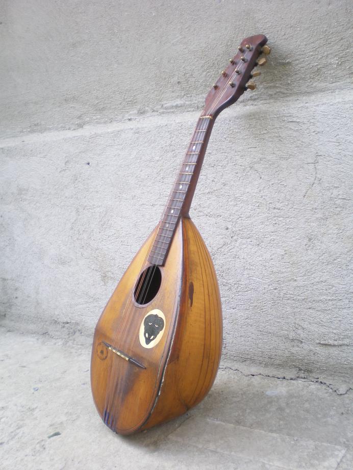

I own an old mandolin, which has been kept for many ears in humidity with the strings tighten. As a result of that the fingerboard doesn't forms any more  180 degree with the bowl back, but less (170-175), the bowl back is affected, and it is very difficult to play at the mandolin(not to mention the fact that it doesn't play the right notes).
Is there anything that could be done? I was advised by a luthier(the only one I could find in my country, they are very rare) to file the fingerboard.
What do you think?
Many thanks
here is a picture of the mandolin:
http://www.bu-dinca.go.ro/IMGP1226.JPG

One thing about not fretting correctly, is the bridge.
It appears to be too low on the body. It should be on the other side of the bend in the top.
Measure from the nut to the 12th fret and double that for the location of the bridge.(plus a bit for compensation)
A picture of the side view, showing the angle of the neck in relation to the top, would assist those that are trying to help you.

Looks to me that Tom is dead right with his suggestion that the bridge is too far back. Just a rough measure from the picture shows that it should be on the flat top section of the top, which as Tom says will raise the action. These neck joints don't usually move, probably a dowelled butt joint as in a lute (which I have a lot more experience of!), the bowl shape is inherently strong so shouldn't distort, think of an egg, and there is no sign of the fingerboard moving. So, just measure from the nut to the twelth fret and use that measurement to move the bridge forward so that the saddle is that distance from the twelth fret plus say 1mm. If that doesn't work, come back, with a few more pictures and we'll take the next step.

I guess I'm just used to seeing so many of the Chicago bowl backs, with the occasional Boston or Philadelphia Vega or Weymann style. The Chicago ones do collapse all the time, often leaving no room to lower the bridge and the extension rising up like crazy. They also usually have very unserviceable neck joints, dovetailed under the top or just one piece all the way in to the body. Tater-bugs, inexpensive catalog instruments from the 1890's to the 1920's, pretty much. That's what fills the attics around Michigan.
Hopefully if the neck angle does need to come back it would be the doweled style as mentioned by Mario and Colin. And it's right that bridge looks too far forward, but as Mario said that will bring the action higher as well.

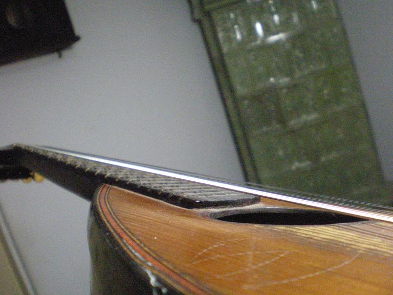

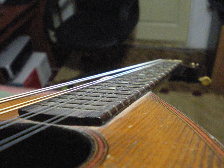

 thank you for your answers, it really helped me get a clue. here are some more pictures with it, sorry for the other objects that appear.
the real question is would i be able to repair it myself?  is it so complicated? hope i will get a positive answer :)

If you look closely it's top is comming unjoined from the sides or maybe its just missing the purfing i can't really tell from the pic.

Top is sinking at the fretboard causing it to bow up on the sides.  Looks like the fretboard is bowing as a result of this also.  I'd say the neck do need reset.
