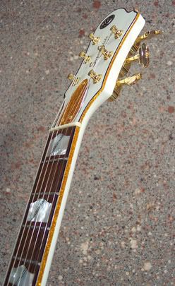

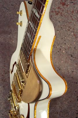

This is where I get what I use:
http://www.precisiondrum.com/html/sparkles.html
It is tricky around the tight radius bends. It likes to delaminate in those areas. You can saturate it back together with super glue.
One thing I found out is that you need to put a barrier coat of something before nitro. Nitrocellulose lacquer will make it craze, and not in a cool way. I spray a two part poly over it, let it cure for a couple days, scuff it, and then continue on with my normal lacquer routine.
Another tricky deal with this stuff is that the color coat is a very thin layer and easy to go through. Around the body this is not too much of an issue, but on the fingerboard edge, it is difficult to complete the edge of your fingerboard in a comfortable way. You have to leave this stuff alone, and can't radius or shape it like a normal celluloid or ABS binding.
Good luck!
Here is a guitar I used this stuff on:

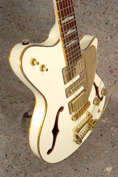

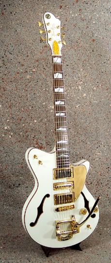

Here are a couple more shots of that guitar:
And here is a guitar with the same material on the top. I used a vacuum bag to glue it to the carved surface:

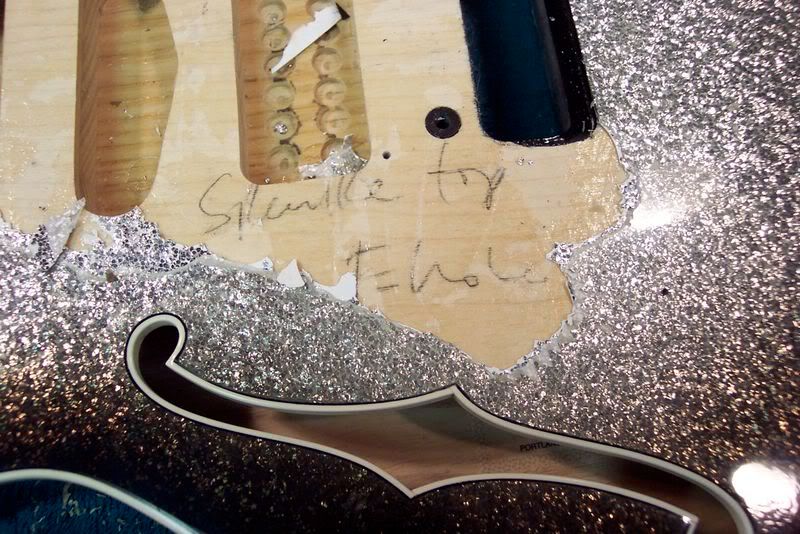

I still use it for bindings on Gretschy sort of things, but for tops, I now prefer to spray the flake, rather than use this drum wrap. I had one instrument returned because of delamination. It was on a stand on the stage at an out door summer concert. It bubbled up a little...
It was a pain to remove:
It came off only in little chips
