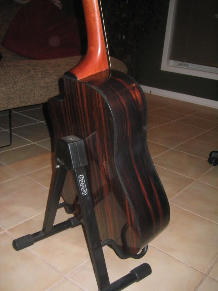

I know that lots of people use fiber bindings with success. Taylor guitars for example. As I said, I think the key is to install them close to perfectly so little or no sanding is required. Here is a picture of the guitar I did with fiber bindings:
IMG]http://i274.photobucket.com/albums/jj247/Pat_Hawley/133_3347_r1.jpg[/IMG]
I'm not sure how it will turn out but the idea is to show that the colour of them is not uniform. You may be able to see, for example, that they are lighter in the waist area of the guitar.

What about Ebonol? I wonder if anyone makes bindings out of it. From the picture it looks just like black plastic.
