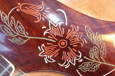

ok, I've been experimenting with this for a while now and I think I finally have a system that works very well. I'm now using System 3 SB112 epoxy (which you can get from LMII). It cures slower than the zpoxy and has a very high gloss. I'm also using Transtint dyes that I bought from Woodcraft. Start by mixing a small batch of sb112 (50 grams resin/22 grams hardener). Once it is well mixed, pour it out into 2 separate containers. To one, add about 5 drops of "honey amber" transtint dye. to the other add about 3-5 drops of "dark walnut" dye. Other colors are available for experimenting... Once I have my tracings under the shrinkwrap, I take a good artists paintbrush and (using the lighter colored epoxy) paint around the edge of the pickguard, going right up to the line. This thin coating of epoxy will create enough surface tension to prevent the epoxy from running outside the lines. I then use a popsicle stick to spoon some amber epoxy out into the pickguard and spread it out in long lines. I then spoon out some dark epoxy into the open spaces and spread it out to fill in the gaps. Add more epoxy slowly and in small amounts until it flows out up to the lines. You can use a toothpick to trace around the edge and smooth the edges out. This is what the end result will look like. - Good luck and let us know if you try this out... - Justin

Very cool, thank you for the pictorial!
I would be very curious to try this in a mold followed by placement in a hard vacuum. Now I half wish my next project wasn't a solidbody!
