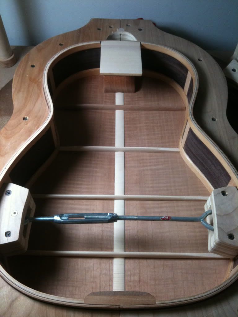

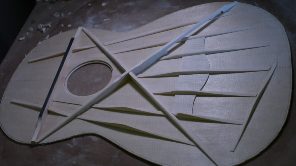

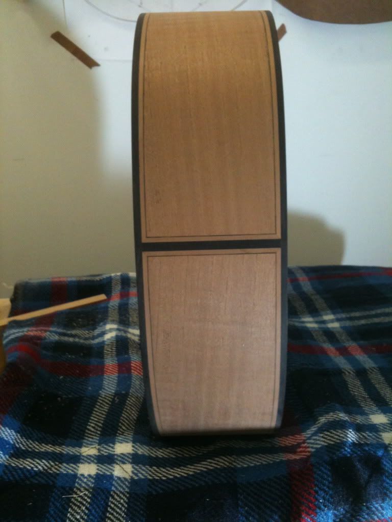

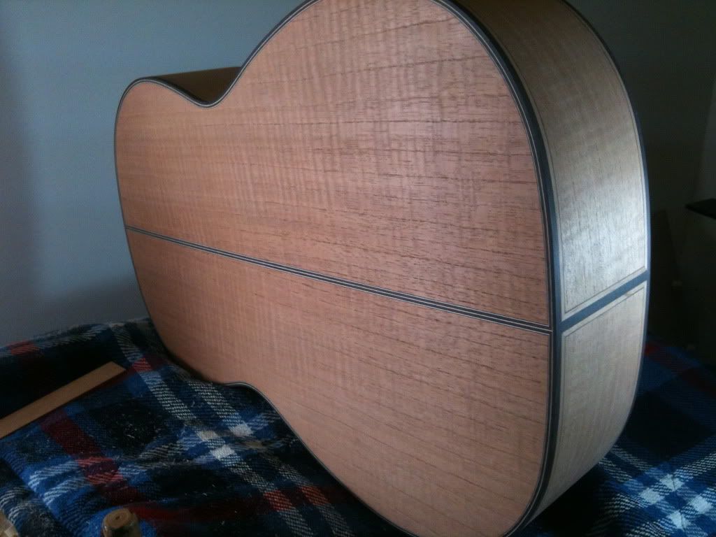

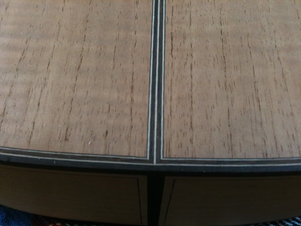

Oddly enough, I also build almost exclusively nylon string instruments but had an acquaintance recently insist that I build him a steel string guitar. So, this is what I've been working on. These pics are a couple of weeks old. It's actually sealed, wash coat of shellac, and ready for pore fill now. Today, though, I'm removing the fingerboard-don't ask.
I'm using my classical plantilla and Jeffery Elliott's hybrid fan/X brace pattern. I'm also using Colin Symonds' neck joint.

William, that is really interesting. So many nice things going on I don't have time to list it all! (though the purfling scheme did catch my eye) Looking forward to hearing about the results.

Forgot to mention b&s are curly Spanish cedar, top is lutz.
