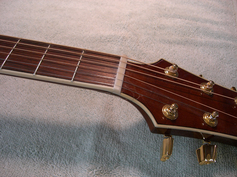

Just thought I'd provide an update.
I made a new bone nut about a week ago, strung up the guitar and have been playing it every day.
So far, so good. The repair is holding up fine and the strings are staying in tune.
Next step is to take everything off and repair the finish.
Dan
