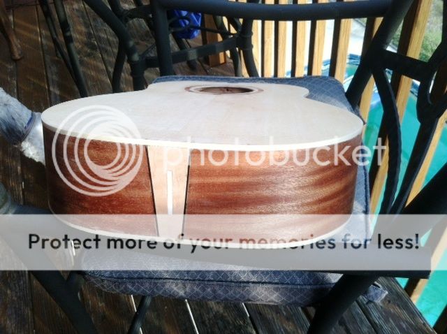

Scraped the binding;
(I know it's pretty basic, but I'm so pleased with my end thingy)
I still need to floss the cheeks, but the neck is "set";
Bridge pin holes are started with a 3/32" bit as is the bridge slot, but there's still much to do there.
Fretboard end at the soundhole is close, but not done as I'm taking a little off at a time to make sure it doesn't
get all katty wompass. And, ftr, the fretboard & bridge are just stuck in place with a little double sided tape
because I measure the neck set after every step. Yes...even binding scraping.
Anyway, the list is still pretty long, but nothing's cooler to a new builder than that moment you get to take those
mock-up shots. Makes it worth all the sawdust you've swallowed I reckon.

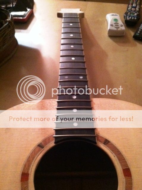

Finally got back home and since the wife wasn't home yet, jumped right back up on that horse!
Frets!!!
Just tapped in at the moment. I had to make sure it didn't look like all I cared about was building this guitar, so
I wanted to look like I was just patiently waiting for her to get home. You don't get to be married 27 years by
being a dummy, you know.
Anyway, since I was on a roll
The very observant of you just noticed I crossed another major milestone. For those still wondering what the
heck we're talking about;
That's right; papa's made a bridge, complete with saddle slot and all! Oh yeah! (I was more than a little concerned
about this step). Now it's time to fine tune things (still got just a smidge of neck adjusting to do so there's no
heel gap at all) and then it's on to final sanding and grain filling. What a great ride it's been, and quicker than I
imagined as well.
Sitting on that flat table, I was finally able to really get a view of the whole "radius thing" on the back;
As you can tell, "Maddie" is not overly impressed, but I kinda was. All she cares about right now is being warm,

Eric, you're doing great! What's the weight on that bridge?

How close are the bridge pin holes to the saddle slot?

@Beth - I have no idea. I didn't even know I should've weighed it. Is there a target weight I'm after?
@Rob - You're just teasing about the negative sign, right? Because if not, that's just plain crazy talk and you might need counseling.
@Mike - Isn't that the coolest thing you've ever heard?
@Clay - Offhand, I don't remember but I took the dimensional advice right out of the Cumpiano/Natelson book, so whatever that said.
I'm shooting for a depth of 5/16" on that slot, I'm assuming, which is half the thickness of the bridge. Is that right, anyone?

I use a kitchen gram scale. I've been told to shoot for the mid-20s (grams) at least for the mid or larger guitars. Maybe someone with more experience can weigh in (yup, I just said that:) about target weights and other bridge/bridge plate considerations.
