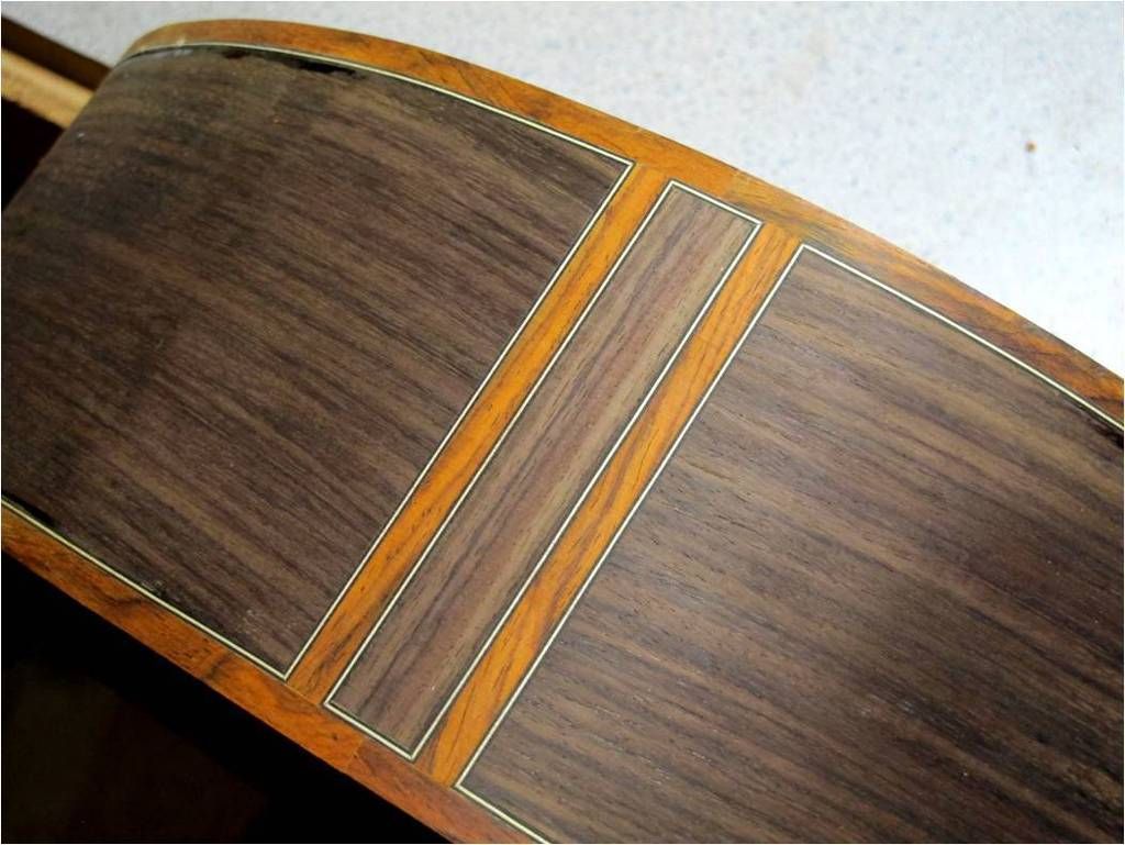

Michael - Here are a couple photos as follow up. I bent the side purfling for each side sandwiched between the binding strips for each side using my hot pipe. Worked great. I glued the side purfling in first with CA and then installed the binding and top/bottom purfling as usual. I had no problems keeping the side purfling flat in the binding channel. I'm happy with how it came out for the first try at side purfling with mitered joints. I have a pipe clamp setup on the side of my bench that's like a Troji so I used that. Your tip about gluing uphill was a huge help. It was good to know that from the get go instead of figuring it out the hard way.

Looks very nice. You did an excellent job. That is going to be one beautiful guitar - Mike
