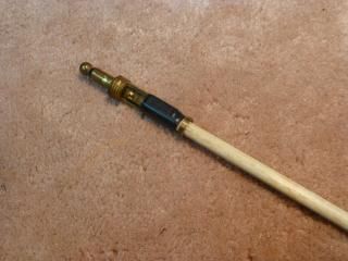

This is what I use to fish the jack through the tail block.
Tom
No it's not..................having a awful time with this computer and picture stuff......wish there was an erase button.

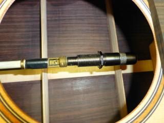

Jack fixed to the plug as seen through sound hole.

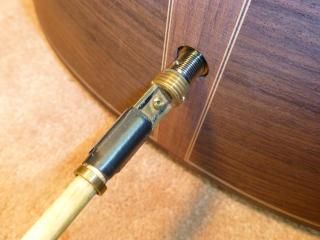

Jack pulled through hole in tail block.

For fishing the jack out through the reamed (or drilled) hole a 1/4", long drill bit works fine so too does a 1/4" wooden dowel.
