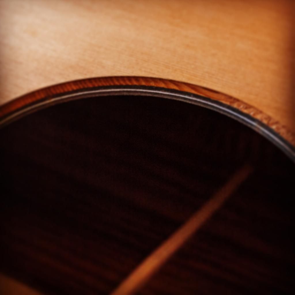

Everyone has their own "minimal" and mine is getting more minimal all the time. When I first thought about stripping away the decoration it really made me look at my body shapes, and my headstock. Likewise I started to re examine the role that decoration plays - beauty is a function just like playability and sound. But much of the decoration we employ goes way beyond the practical role it plays.
This year I decided to make a guitar bouzouki with a rosette inspired by Canadian luthier Ed Klein:
Another thing Ive done is to "double bind" with black, and rout with a roundover bit (rather like a Tele) It looks really smart when its sprayed.
But even on some of my more expensive instruments I now only bind the top to protect it - I love the way the sides and back blend into one another in rosewood (cocobolo in this case.)
