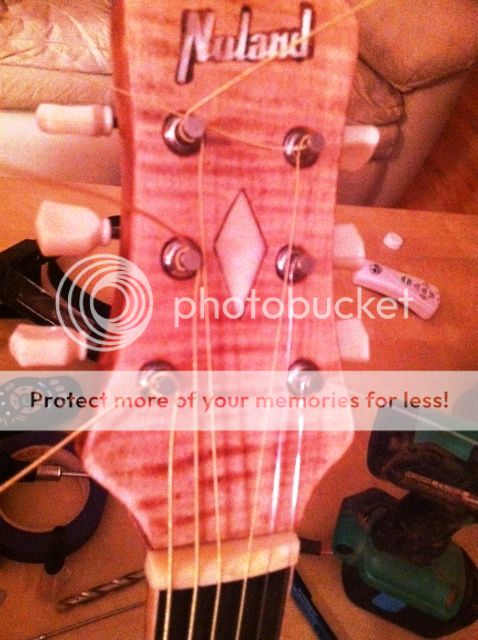

Well, I'm not 100% sure how it happened, but it happened. She's done!
Had to recess the little top thingies for the tuners as I did leave the headstock a smidge too thick, but it works;
I'm giving myself an A for effort on this one as I kinda shocked myself by pulling this off, lol. Of course, there's
still some fine tuning to do here and there; shaving down the saddle and doing final intonation, finishing the nut,
etc. However, since I've read so many times that they need to "settle in" for a week or so, I'll probably leave it
alone for at least that amount of time and finish when it's time to rub out the nitro. I'm very pleased with the
sound, although I don't have an acoustic here to compare it to. I'd call it a "full bodied" sound and I thought it
was relatively loud. Maybe when it's done-done, I'll do a clip or something.
Thanks to all who weighed in with both advice and encouragement and HUGE kudos to Rob McD as it was his awesome
generosity that got this whole thing started and me motivated to give acoustic building a try. I must say; I'm hooked.
#'s 2 through ? can only get better.
