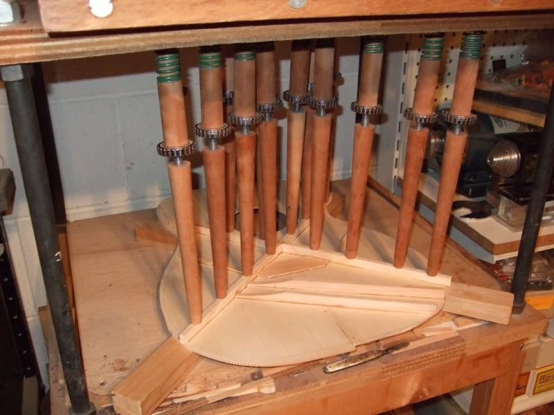

I built this deck in 1982. Adjustable go bars with springs on top has worked great. I do the adjusting before installing. To install, I place the bottom end on the brace, then slide the top over until the go bar is vertical.
Great setup, John. I have been thinking about making adjustable go bars, or spring loaded go bars. and yours answers a lot of the questions I had. Now I can have both.
Yours should be called a "GOOOO BARRRRR" deck, since it can do some pretty heavy lifting. :)
