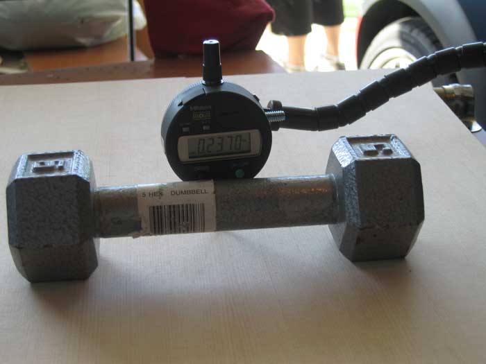

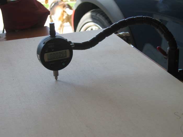

When I do my deflection testing I do it prior to joining the tops, but they are thickness sanded, usually around .160-ish. Measure the top with a micrometer in many places and average the results. Try to get the top as even as possible of course and the averaging will help. .002 is pretty typical of what I see off the thickness sander.
I do simply supported, between two centers. I use metal tubing for the centers as it's pretty straight, much straighter than wooded dowels.
For weights I use some cheapo exercise weights that i've weighed on a gram scale. You don't want a whole lot of deflection just enough to get a repeatable, reading from. I usually shoot for .04 inches, but the readings will vary of course by about +/- .010.
I test both axes using similar setups, adjusting the supports for the dimensional changes. Make sure to load the top across the entire width, not just in the center.
Once you have this data and calculate the moment of inertia (b*h^3)/12 you can calculate the modulus of elasticity. This is the number you're after unless you just want to make all of your plates the same dimensions and just leave it at "this plate is stiffer than that plate type of thing.
I also think it's a good idea to keep a standard and check it at the beginning of your testing session to verify everything, sort of a calibration check if you will.
Hope this helps.

Shane, i'll pull out my fixtures and take a pic or two. More info coming a little later.

Here are the only picts I could find. It would be better if my weight was a bar to evenly distribute the weight, but I have been using this so far and my results are fine.
Numbers for the deflection are kind of meaningless taken out of context of the entire system and bracing etc. For what it is worth, here is some data on my L-OO

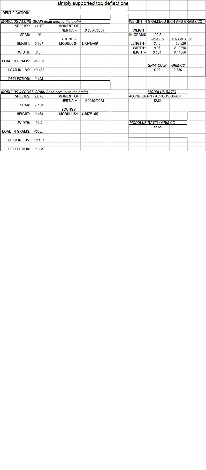

Here's a sample of the way I keep my data and what I check.
My weights a little heavy in this sample. I think about half of it is about right.
As you can see I just set up a standard spread sheet and track my data that way.

JIm, I assume you have the formulas embedded in that spreadsheet, right?   Can you display that?

Jim my friend I really like your record keeping and spread sheet - any chance of sharing the spread sheet (without your data or course)?
