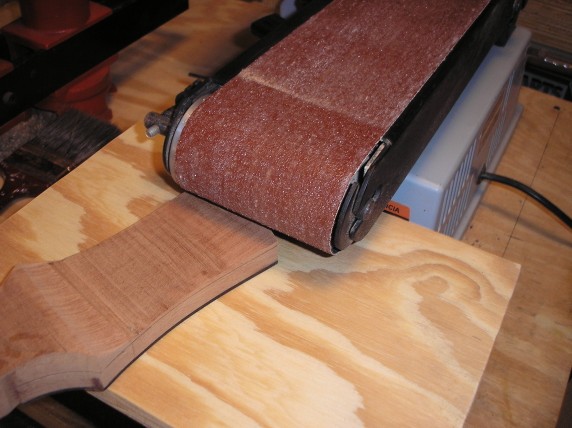

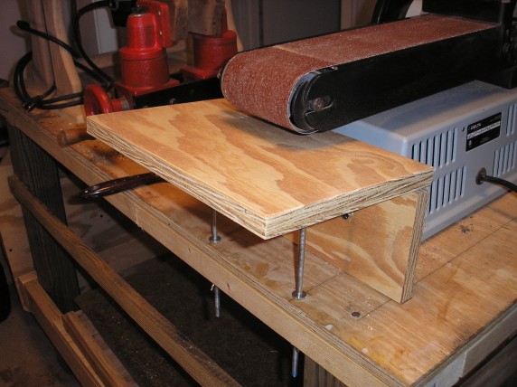

We use a belt sander.
The pic below is a bridge but the headstock works the same way and makes a great volute as Tony says.
Bob

PostPosted: Tue Jan 08, 2008 11:05 am

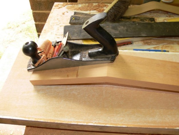

This could be fun (just fer roughin' in...)

hey bob,
your system looks like it makes a lot of sense - and even leaves room to tuck the end of a shop vac in somewhere. could you show us another picture or two of how you make adjustments?
phil
PostPosted: Tue Jan 08, 2008 1:21 pm
Posts: 698
Just a couple of wing-nuts Phil

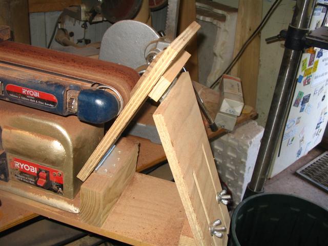

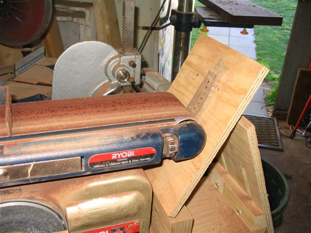

PostPosted: Tue Jan 08, 2008 1:23 pm
Bruce, I made this simple jig that works well for
headstocks and other things like brace ends and bridge wings.It makes a nice volute too.
