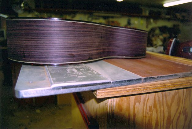

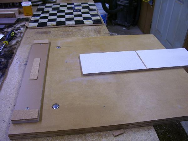

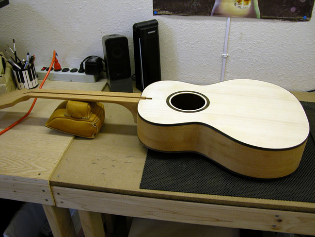

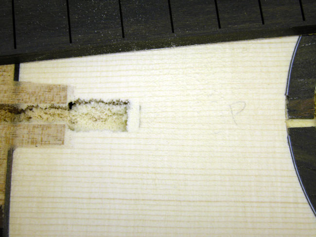

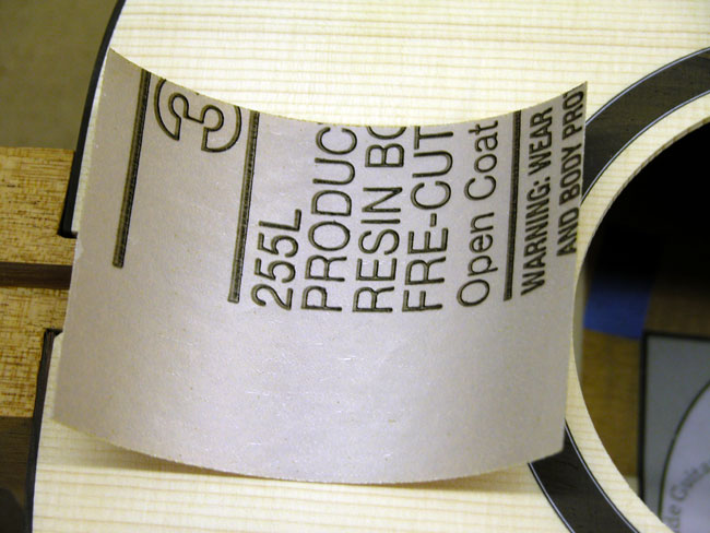

I made this sanding jig to sand the upper bout to the correct angle so I can have a 1/2" saddle height from the top plate. 3/8" bridge and 1/8" saddle above the bridge.
The guitar rests on the center piece of cork at the bridge location. The 2 outer pieces of cork keep the box from tipping from side to side.
Here it is in "use".
On my sanding board I have 80 grit on one end and 220 on the other. The sanding board is the same thickness as the board with the 3 pieces of cork.

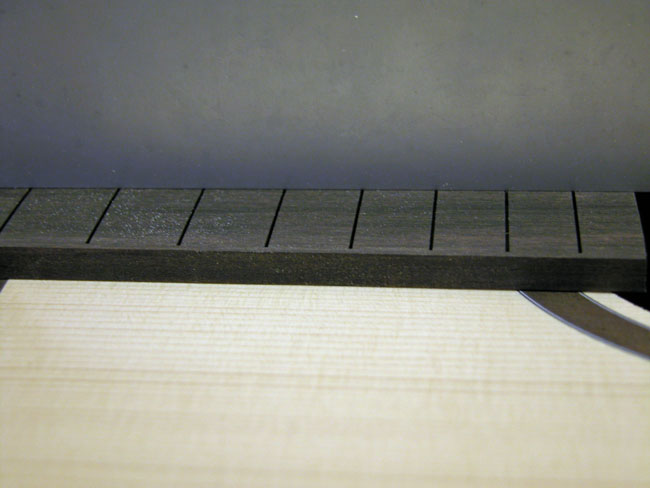

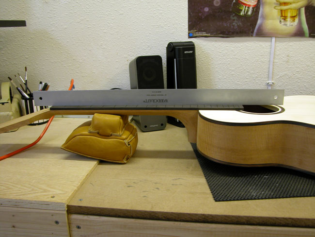

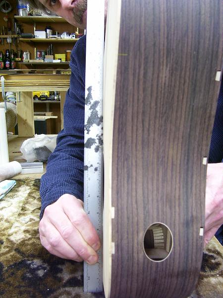

I'm trying to get about .050" gap at the bridge location when I hold this straightedge on the fingerboard gluing surface.
right now it's about .080"
Horton, MI
PostPosted: Thu Jan 10, 2008 12:03 pm
Posts: 493
Trying to get this all in before my dial up connection craps out.
So, basically the thickness of the center piece of cork determines the gap I get with the straightedge (less the thickness of the sandpaper).
Does any of this make sense?
Any comments about my setup would be greatly appreciated.
As always, thanks so much.
Horton, MI

Thanks Simon,
I thought of doing it that way, but my sanding board was hitting on the bottom part of the sound hole (bridge side). I didn't see any need to sand all of that area. Maybe a 25' radius is just a tad too sharp.
What thickness of shim do you use at the bridge location?
Anyway, I raised everything up so that area would clear. That way I can concentrate on the area above the soundhole. I got this idea from Jim Olsons website.
Here's his:
He moves the guitar on his but I'm moving the sandpaper on mine.
There shouldn't be any guesswork involved once I settle on the correct gap at the bridge. It should all depend on the thickness of that center piece of cork.
Does .050" seem like enough???
I've heard that when the fingerboard is on with the frets in, a straightedge on top of the frets should just kiss the top of the bridge. Taking my previous numbers into consideration I calculate .082" gap.
.375   bridge height
-.043   fret height
-.250   fretboard thickness
______
=.082
If .082" is a better number then I'm pretty much there without any sanding, and that would be great.

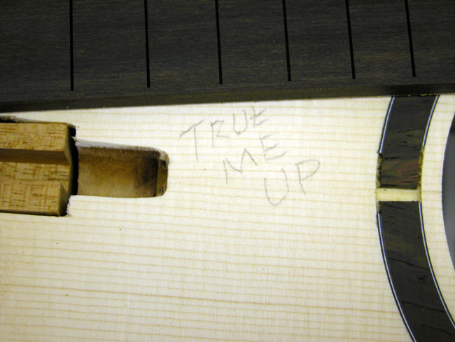

No, not sanding a notch just tweaking the angle on the upper bout so the fingerboard makes a smooth transition at the neck/body joint. Just need a flat wide enough at the correct angle to glue the fingerboard to the top.

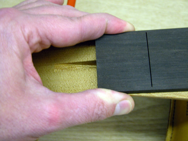

This is what I use to sand after the top is on.  There are many variations on this theme.
Terry

What you are doing will work - it is just a matter of how well it will work
for you. I can't imagine Olsen doing anything that wasn't well thought-
out and highly efficient...
You also have to take into account the bridge area "rising" up a small
amount under string tension. It isn't substantial for my guitars but I do
take it into account. I like to have a good 1/32" air space above the
bridge going from the top of the frets.

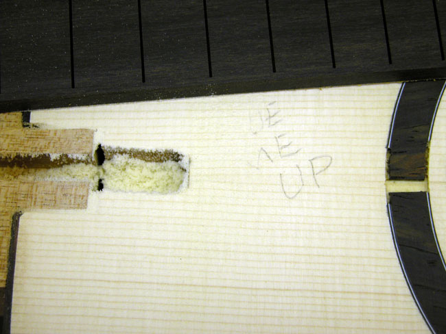

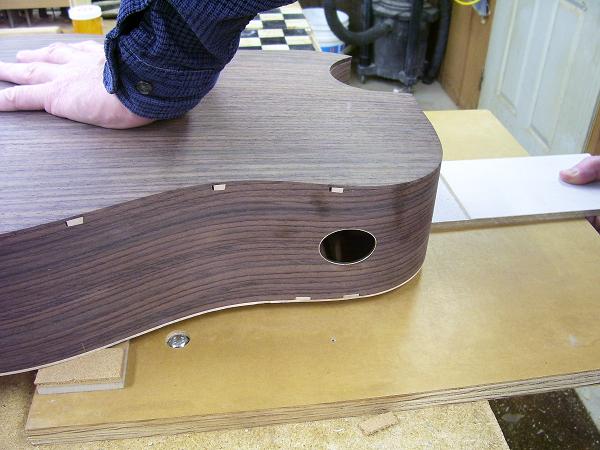

For me it starts with how I construct the guitar.  The upper transverse brace is not radiused at all which flattens my upper bouts.
In addition, prior to putting the top on, I sand the rim on a flat board, face down, with a 1/8" shim under the tail block.  I make pencil marks on the "kerfed linings" from the center of the waist all the way through and including the neck block.
With the rim face down I move it back and forth on the flat sanding board a couple dozen times until the marks are gone.  This effectively takes the radius out of the upper bout and flattens it.  Then the top, with the flat upper transverse brace goes on.
IMHO the advantage here of building the correct angle into the box is that you don't have to sand flat the top in this area and if it needs any attention at all it is very minor.

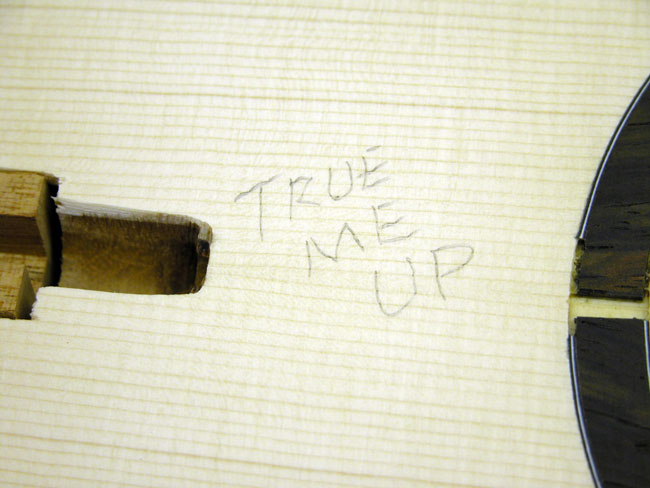

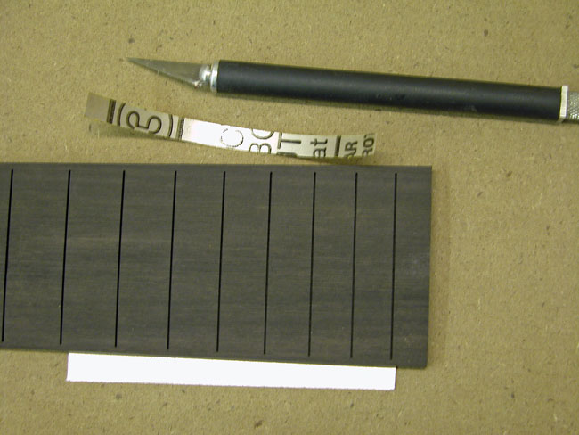

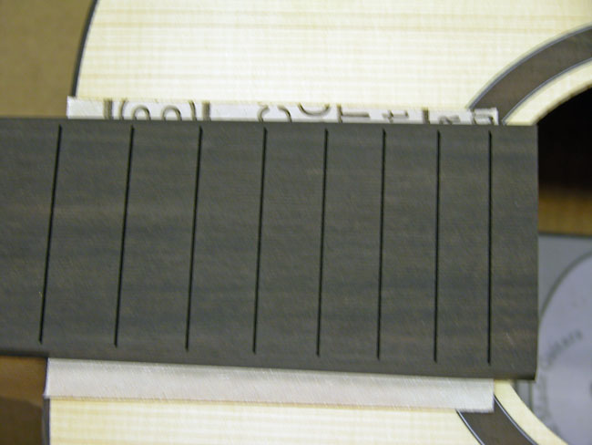

In the event it needs attention for the fret board to sit nice and flat I use the fret board as the sanding caul as below.
Notice that this is very fast and easy - just the way I like it.....
Often, because I build the upper bouts flat I don't have to do this at all.
And then of course when the fret board is leveled on the neck/guitar I can also sand in a slight drop away from the 14th to the 21st frets.
