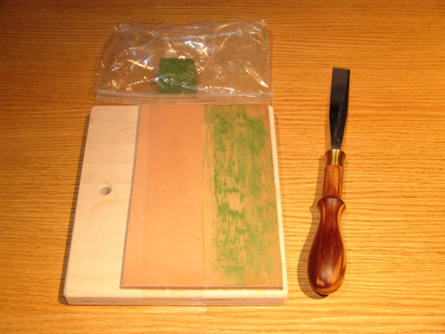

I learned to sharpen on stones first, but invested in a Veritas power sharpening system for convenience...
If your buying quality Japanese stones and grinding/honing wheels, low speed grinder, diamond paste, etc its probably comparable in setup costs to a power sharpening system really
(however you are locked into buying replacement disks with a power system mind you)
Well the other day I changed an angle on a plane blade and sharpened it to freakishly sharp in about 7 minutes with this setup - It would have taken me all afternoon on stones,,,

Another scary sharp man here. I'm sold on the "system"... I have some plexiglass pieces with papers stuck to them. But the best advice I could give is that once sharp, don't let them go dull! Don't work until you feel the edge going dull; if you did, it's to late. I strop it using 1200 or 1500 on the plexi(or real glass) at least twice while carving braces, for example. It becomes a habit. Strop lightly before commencing, and during. Just do it.
Maintaining my chisel's edge like this, I only sharpen it maybe once a yea or 18 months, or if I've hit something(sand, metal, etc...)
The difference between a good chisel and a POS chisel is the steel, of course, and poor steel won't take an edge, much less hold it. It really changed my view once I got a good chisel. The same technique to sharpen never gets the same edge on my cheapies, not even close, which are relegated to scraping duty, mostly. Steel has grain; the finer the grain, the finer the edge, and we're talking at a degree we can't see.
Expensive? No way! You only need ONE good chisel. I have a long, beveled edge 1/2" chisel which lives in my hand. I do 98% of my work with this one chisel. The odd job that asks for a wider or narrower chisel is fine for the cheapies. And by using just one chisel, it will become an extension of your being, and you and it will become one. Sounds quirky, but it really can be so.

I have an LMI 18mm that just fits my hand very well and holds an edge for a long time.  Just as important it just feels right to me and I do have other chisels too, some pretty high quality, but I like this one.
So I use it all the time and in doing so I am probably a better carver with it.
It was also the first chisel that after sharpening I was able to experience a chisel sharp enough to pop the hairs off the back of my hand.  I think this speaks well to the steel used and what Mario said about good steel being able to be sharpened sharper then lesser steel.
I was stropping it several times a session on my 8000 stone, dry, until JJ heard this and took pity on me.  So JJ sent me a surprise that he made for me to strop on and I am looking forward to using it.  And yes JJ bro I WILL take the tape of the dry side before using......
