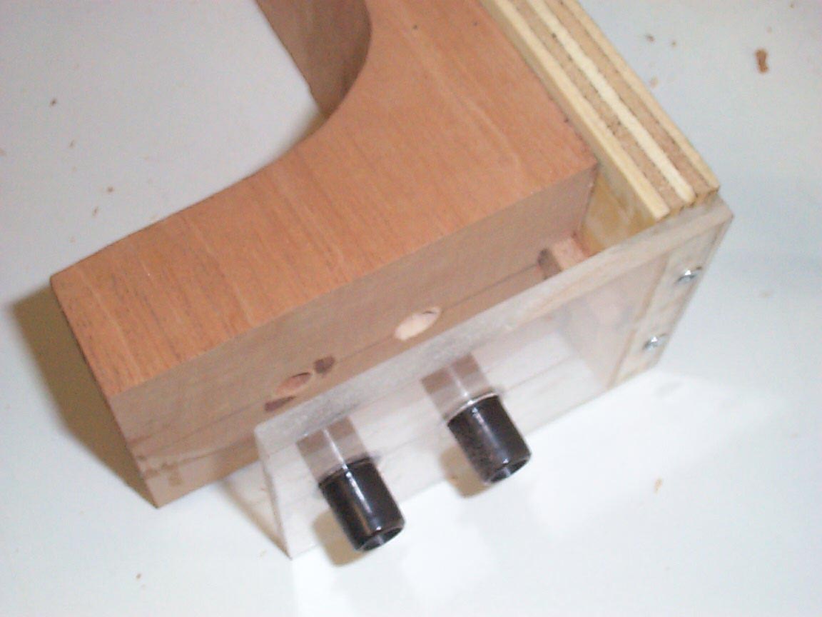

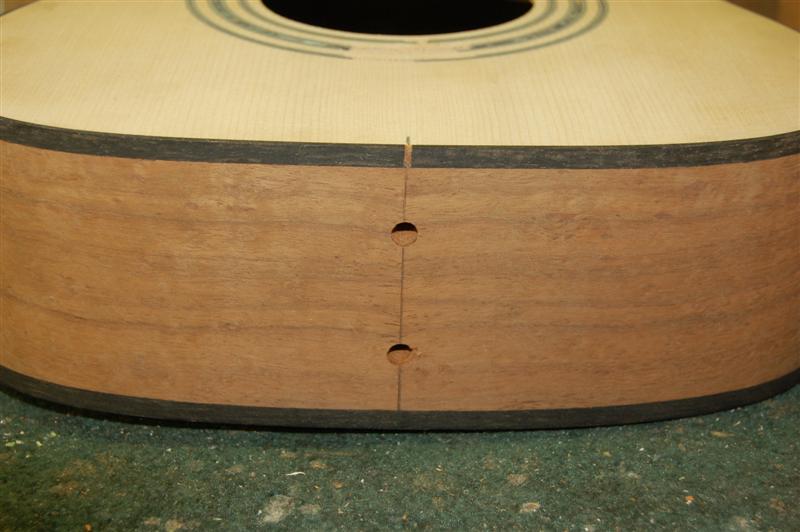

First I drilled to 9/32" holes through the neck block to allow a little wiggle room for the 1/4" bolts:

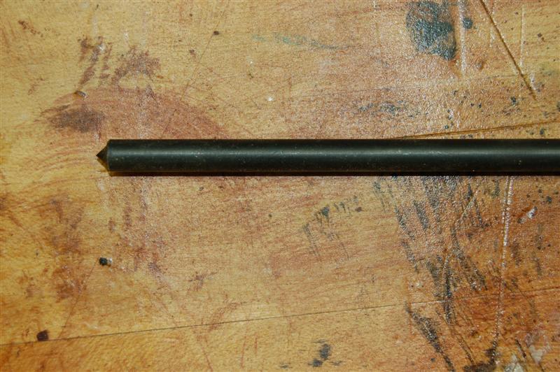

Then I use a transfer punch (great tool!)to mark the exact location of the hole centers in the headblock to the neck:
Here's the whole set of punches:
Here's the one I am using:

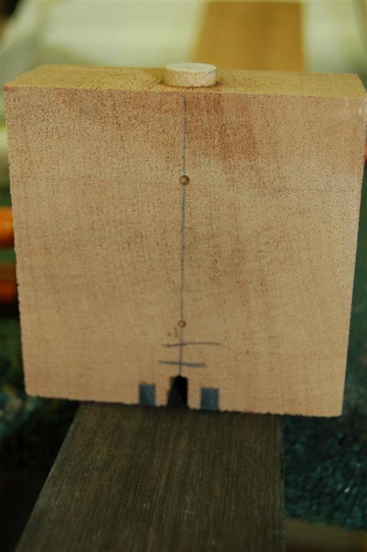

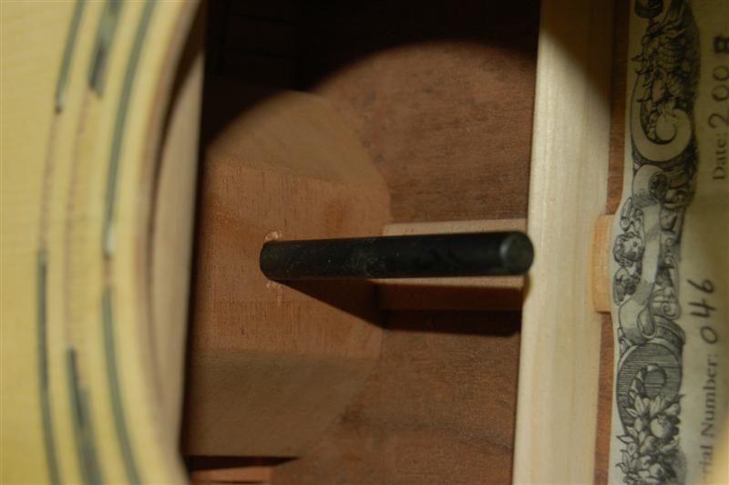

Here it is inside the guitar-simply push it with your hand and it transfers the mark to the neck:

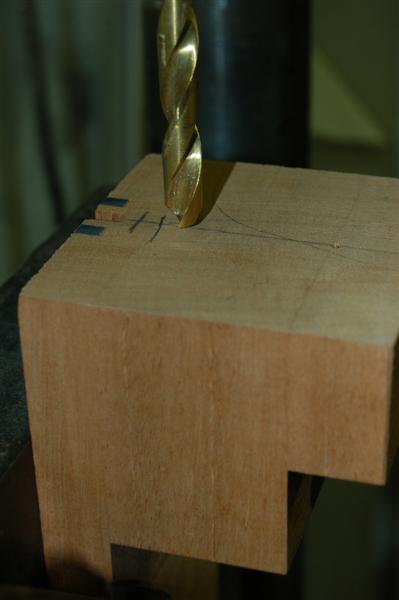

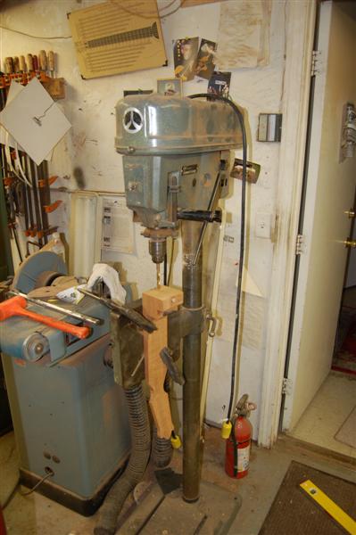

Next I drill the holes for the inserts-as you can see there is already a 1/2" dowel inserted in the heel for the inserts to bite into. I am using my drill press for this operation.My drill press has a unique feature-the table turns horizontally so I can drill the holes with precision:
After I drill the holes to a little deeper than the insert I chamfer the holes.

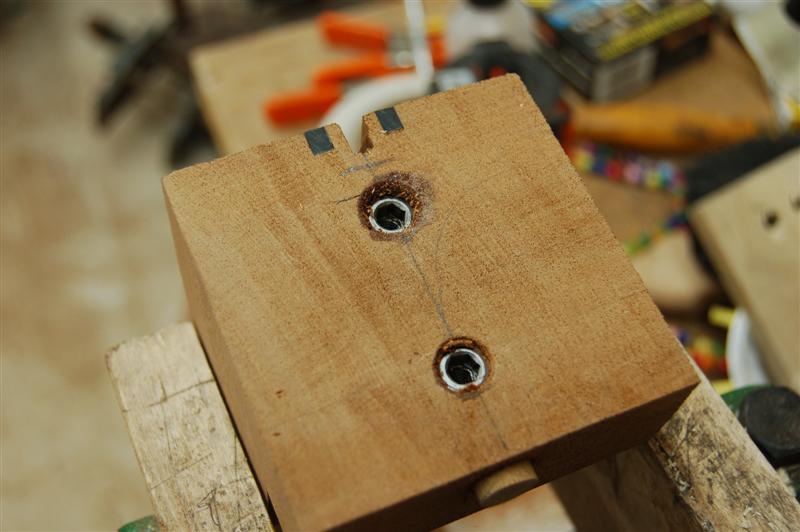

And finally I screw the inserts in using a little thick CA with a cordless drill on low being careful to go in squarely.
I really like how this is working out-everything lines up nice and the inserts aint comin'out!!

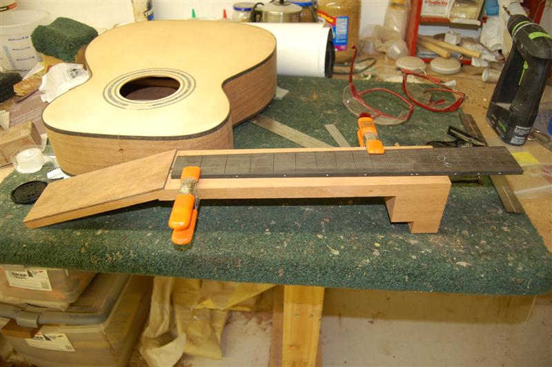

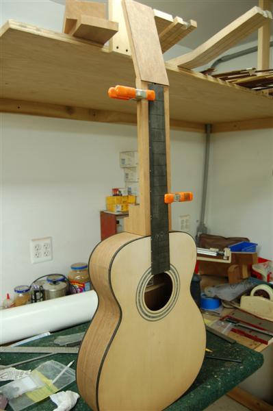

How do you align the neck and hold it in place while you are using the transfer punch? I've found that this is a hassle without a mortise and tenon to help with alignment.
Any tips?
PostPosted: Sun Jan 13, 2008 3:29 am
Posts: 2221
John,
Funny you should mention that, because I forgot to post the picture of that step-so here it is.
What I did was clamp the fretboard on the neck with a couple of spring clamps and lined up the center line- I simply held it there while I pushed the transfer punch in:

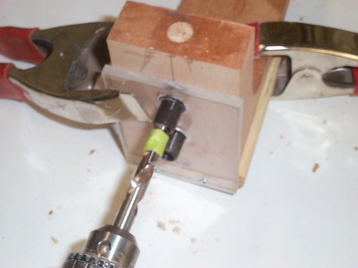

This is all cool, and it's very much how i did it for years, even down t the drill press and punches. I finally just made a pair of simple jigs with drill bushings, though, and can build the neck and body separately, and everything lines up in the end. And it means my necks are  now interchangeable/replaceable....
But you can also clearly see why I moved away from the inserts and toward the hanger bolt. Not a whole lot of that dowel is left. Yes, the inserts are in no danger of being pulled loose, that will never be the issue. But the heel can crack too easily from an impact, if you carve it as dainty as I try to do mine... The hanger bolts leave a lot more dowel, and leaves a much stronger heel area. Also simpler to install.

Do give the bolts a try. Don't get me wrong, the inserts served me well,  and they'll serve you well also, but I did have two necks crack at the insert hole after accidents. Neither one opened up(thanks to the dowel), and both repaired perfectly with a little hide glue and have held up for years now, but it did make me look at it all to see if it could be stronger.
