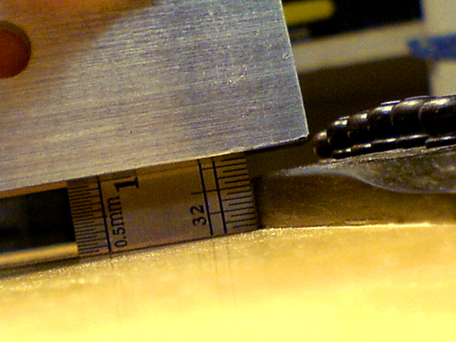

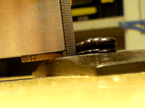

Here are a couple of images that might clarify things:
In both images, the straightedge is lying along the neck centerline, and is 1/8" clear of the bridge. The back angle I mentioned is in the saddle, which seemed like a good idea at the time, in order to resist the saddle's tendency to roll forward over time.

Thanks Ken for measuring the neck angle and taking photos of it for us.
I am hoping that others will weigh-in here because I don't want to give you bad advice.
To me what you should do to fix this depends entirely on your own personal guitar building goals.  If this is your first of potentially many guitars I would do one thing.  If this is possibly one of the only guitar that you will ever build I would do another.
I think that there are two things wrong here.  First the neck angle is to great, as evidenced by the straight edge 1/8" over a bridge that is not really to high (5/16").  The second thing that is not right is the location of the saddle and the inability to properly intonate the guitar.
