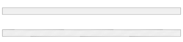

PostPosted: Mon Jan 14, 2008 7:24 am
here are two more sketches looking at the top or bottom of a brace plank. The top one shows the grain with no run-out
The bottom one is with the grain running out to the sides of the brace plank or not in line with the geometry of the plank
PostPosted: Mon Jan 14, 2008 7:39 am
One more thing: If the grain when viewed from the ends of the plank are nice and vertical then I would not expect to see many grain exit points on the sides. (the lines on the side)
None the less if the grain is nice and vertical when viewed from the ends I would not necessarily reject this brace. but if the gran is running out in two axis I would have concern.
