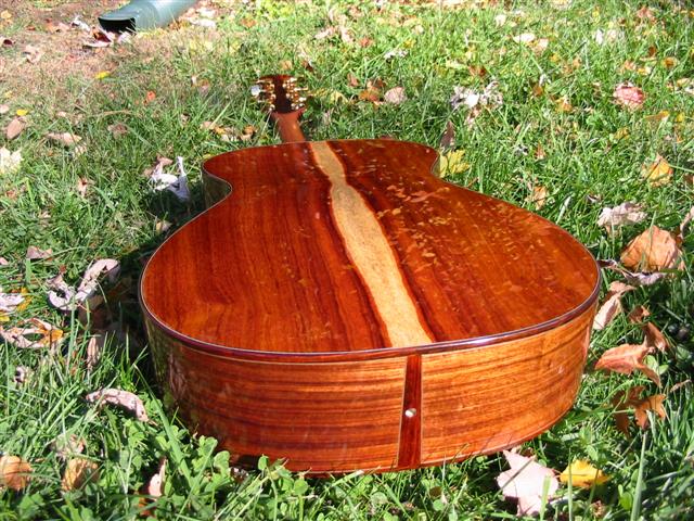

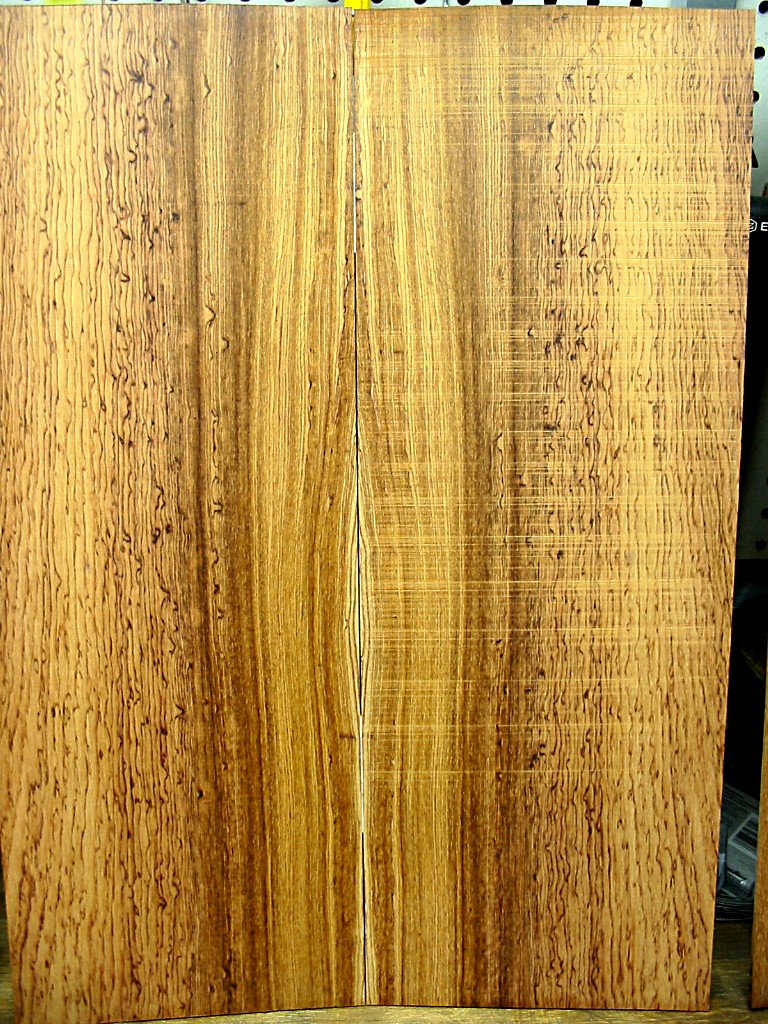

My first big wood purchase from LMI included Granadillo & Palo Escrito. The Granadillo DOES have pores, and it DOES sand. I built 1 Grenadillo out of 2 sets. I have 2 sets of Palo Escrito. I think it bothers my respiratory system. I havn't built with it yet. Here's Palo Escrito:
Below is Granadillo with sapwood:
The Granadillo finished with more reddish brick color. Check out the guitar I made with it...
Here's a link to a previous post when I finished the Grenadillo guitar: http://luthiersforum.com/forum/forum_posts.asp?TID=3253& KW=terry+stowell+grenadillo#forumTop

I like the greanadillo best too. Does a lot of Palo look like that? Or does it have a lot of variety?
