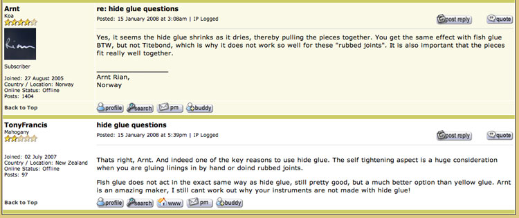

I'm certainly no expert, and I bow to Colin, Arnt, and others on this, but from what I have read, Fish Glue has exactly the same drying properties that HHG has relative to sucking the joint together.  The primary difference being only the heat.  They are both collagen glues, just from different sources.

[QUOTE=Hesh] HHG has the ability to draw the two halves together too, even though you still should be clamping them, and FG or Titebond can't do this.My choices for joining plates are in this order:1)  HHG2)  FG3)  Titebond/LMI white
Hesh, Fish works just the same as HHG and draws the joint together as it dries.

OK I stand corrected.  Where it came from was this series of posts that happened a couple of days ago and the thread ended, for now, after the last post.  This led me to believe that the clamp effect is exclusive to HHG.

Sorry that came out so small and difficult to read.......
