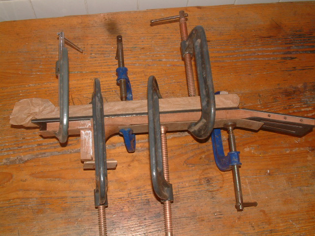

I didn't want to highjack J. Brown's thread about joining tops with fish glue. So, this is a question about using it for gluing fingerboards. A good friend of mine says that he only uses HHG for this because there is no creep - where there can be with LMI and Titebond. Have others used fish glue for this - and how were the results?

I use fish glue for a lot of things, but not fingerboards. I believe fish glue, hide glue, LMI and titebond can all cause swelling due to the moisture. I am sold on the idea of epoxy, which should cause no swelling.

I use hhg for my Weiss fingerboards and on the last two acoustics I used fish glue. It works fine and I have had no back-bow issues. I use a straight piece of mahogany as a caul (as per Cumpiano) and leave it clamped for 24 hours. I radius/level the fingerboard on the neck and use a free-floating extension over the body:

Max buddy I just started using West Systems epoxy for fret boards with a maple gluing caul and it worked great.
I used Titebond for many guitars before that and did have back bow issue more often then not.  I agree with drwhite that any water based glue has a possibility of swelling.  Hence the epoxy.

Max...This is the only joint where I won't use HHG. I had a bad experience on my first with backbow and have been using epoxy ever since. If you decide to use FG, I'd take all of the precautions that Dave White has shown. Good luck!

Is there something about the possible and probable problems from the use of water based glues for fingerboards that people just don't understand? You may get away with it, but this back bowing isn't just a myth, folks.   Enough of us have experienced it that it's not just a statistical anomaly.   Are you afraid of epoxy?   Is it just not romantic enough?   Are you just so cussed ornery that what some of the best guitar makers on the planet have found to work well just isn't good enough? Then why ask here?   Just slather any old water and wheat flour glue on and find out for yourself why some of us have chosen another path.
Or better yet, build 50 guitars using fish glue for the fingerboard and 50 using epoxy and come back and tell us how it all worked out.   I've built about 1200 with Titebond for the fingerboard joint and another 2,500 or so with either epoxy or polyurethane glue.   My choice is now epoxy, and there's absolutely no reason to even try anything else.

Well, it's water based, so it will cause expansion and swelling of wood just like any other water based glue. Many folks still use water based, but you may have to make a curved caul to anticipate and counter the swelling that may occur, refining the shape over the course of making a few necks. I've used it for a few necks, but there's certainly good reason for many folks switching to epoxy over the years in my opinion.

Rick, do you feel that the fingerboard should be glued after rough
shaping even if Epoxy is used? If so, why?  Stress relieved during
the carving?

I'm no expert. I have not built that many necks at just over a dozen. I've used epoxy on 2, Titebond. LMI, and fishglue on the others. No cases of back bow in my very limited experience. Many others use water based glues with success.
This has got thinking. Maybe the variable causing this is not moisture in the glue. If it was, wouldn't it be much more of a problem? Doesn't Taylor use Titebond for there nearly 100,000 guitars per year?
Has anyone ever had back bow with epoxy?
Doesn't moisture cause most of the swelling across the grain?
Won't the fingerboard and fretboard expand at roughly the same rate, and then when they dry out return to a non-bowed state?
Isn't the most likely cause of back bow due to something else? Something that is treating the neck and fingerboard differently.......
Could uneven clamping of the fingerboard/neck during bonding initiate that curve, thus taking a permanent set?

Rick, I haven't heard that before. Don't glue the FB on a neck that wasn't carved. It just so happens I decided to "experiment" on this one. I glued the FB and install frets and now will begin to carve the neck. What's lurking around the corner for me? Clinton

[QUOTE=Rick Turner] ...The other issue on those necks was that we glued on the fingerboard before carving the neck.   Double whammy. Both processes are ill-advised.   I should know...[/QUOTE]
I'm guessing thats because carving much of the neck away relieves a lot of stress in the wood, causing the entire thing to bow a bit.
Is it a better method then, to get the neck close to final measurements, then re-plane it to flat, and finish carving or something similar to that?

Steve, please go ahead and do it just like Taylor. Let me know when you get those ten Fadals in.   Oh, you'll have modify one just to true up the fingerboard on finished necks...
Bob has Fadals to make jigs for other Fadals...
Thinking that what glue processes work in a factory that makes 200 guitars a day is the right way for you to do it...and then leaving out all the other things that make it work for them is really dumb.   Sorry, but if you aren't ready to consider each thing you to to make a guitar in the context of each and every process, material, tool at your disposal, then you're just not going to be able to look critically at your own work and solve problems.
And yes, guys, you'll get much more stable necks if you rough carve first.   And you'll never get away with fretting fingerboards off the neck unless you carve the neck pretty close to final shape before gluing that fingerboard on. And you all should know the reasons for all this, whether you want to accept them or not. It's all been laid out here and in other threads in the past. No need to repeat ad nauseum...

Could it be that water based glue is clamped different - higher pressure - than epoxy - low clamping pressure, and that leads to back bow?
Glue isn't the only difference.
