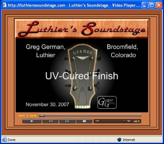

I've been working with a local luthier by the name of Greg German who builds archtop guitars, and he has been finishing instruments with the new UV Cured finish that so many builders are moving to. He said that he will offer finishing to other builders for a fee. He is located in Denver, CO by the way. Anyway, to meet him and see his setup and explaination about the finish, go to the link below. The only draw back is that he doesn't do much finish work in the winter becuase he is not set up with heat in the winter. But on warm days he could do spray. Anyway, just thought I'd pass this on for anyone looking for a UV cured finish. His website is HERE
Look at the video titled UV finish...
LuthiersSoundstage

Bruce,
I know some people have had problems displaying this page if they are using an Apple Safari browser, but I know it works well with IE 7.0. The video does not have a direct link because it is copyrighted. The developer used MS Silverlight do convert the video. Here is a screen shot:
Sorry I can't help you Bruce. But basically he shows you the spray booth and light used to cure the finish, and talks about the benefits if a UV finish...very hard, no yellowing, super thin, and can spray, level and buff all in the same day! He used to spray lacquer, but now he only does UV. I've seen his work and it is perfect!

Hey pretty cool. I need me one of those light bulbs for home land security. Burglar comes into the house, don the protective gear and let him have it!
I had to download Microsoft Silverlight software before viewing, and hey, the sound works, unlike YouTube now on my system.
