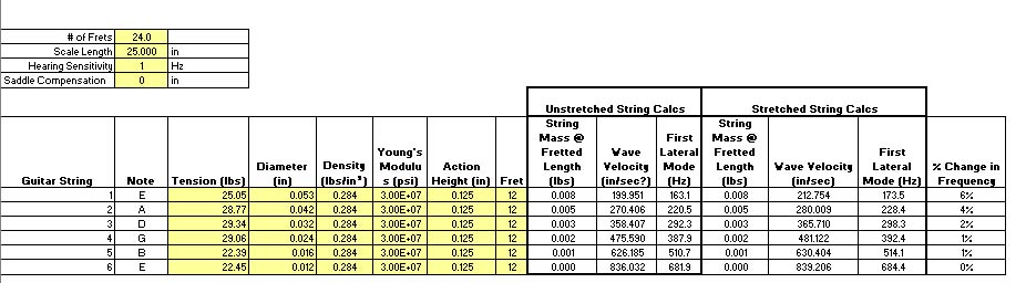

Ok, get a load of this...!
I ran the numbers for all of this. I built a spreadsheet to compare "stretched/fretted" notes with the "unstretched" notes (aka an action height of 0) at various positions on the fingerboard based on vibrating string theory. The spreadsheet takes into account the change in tension due to fretting a string, based on the height of the action at that fret, the fret, and the overall scale length.
According to this hurried analysis, saddle compensation is nowhere near as important as having a low action.
Here's a screenshot:
..and Here's a link to the actual spreadsheet, for those who want to mess with it. Only change the values highlighted in yellow....all of the other cells have formulas. Also, there are a bunch of hidden columns in here...feel free to unhide them in order to see more of the logic.
http://www.mediafire.com/?2gkulx3zm93

One more thing...that spreadsheet does not compensate for an overwound string. It could, but it has been setup for the simple case of a plain string.
