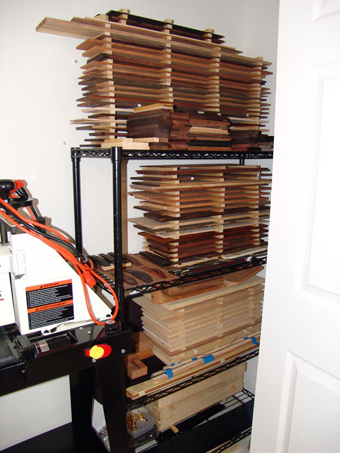

Rick not a daft question at all my friend.  When I started I had the same question.
Stickering refers to stacking the wood with "stickers" or spacers in between the various pieces to encourage air flow.  Stickers can be many things so long as what ever you use does not stain the wood, is flat, and supports the weight of the stack - cheap helps too.  It's also using the wood to weight itself down when in a stack as pictured below.
I write the date and what ever it is on each set.  But...... a label that could be read from the side of the stack would be very welcome here....
