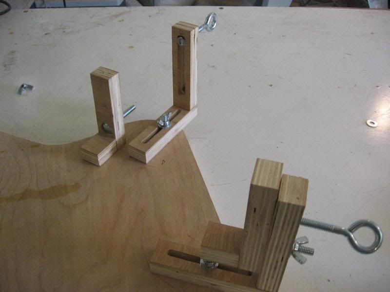

Here's a couple more. Nothin' fancy, I'm more of a function over form kinda guy.
Fretboard taper sled. Just does one taper, but works well and will be the main taper I use. I can always do custom tapers the old-fashioned way or throw together a new taper sled in just a few minutes.
My version of the mini thickness sander. Had to study out the adjustment mechanism. Wound up using two screen door hinges to keep tension on the mess, still need to cut the allthread off and countersink and epoxy the nut. Yes, that's dust and a lot of it. The DC is currently just dedicated to my thickness sander. Once I get a couple of guitars out of the way I intend to properly route my DC system and upgrade the electrical.

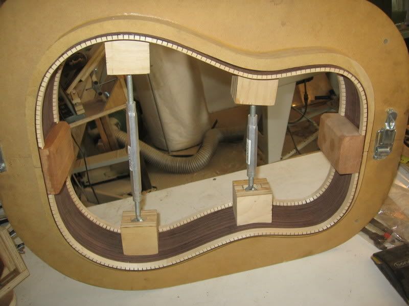

My body holding fixture. I wanted a way to add more tension to the sides of the body once it's locked down, so I added these to the uprights.
Pretty stable! You can pick up the fixture by the body and it doesn't move.

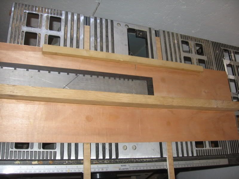

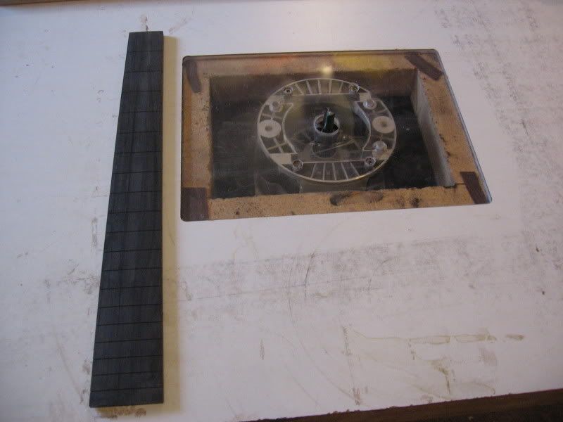

Keeping with the KISS philosophy, here's my fingerboard slotting rig on a dedicated tablesaw. The 2-sided template was cut on a digital endmill, so it's dead-on accurate.
Built my compound radius jig with an extra-long bed. Radius starts at 10" on one end to 20" at the other, allowing you to change the radius simply by where you place the nut on the jig. Here I'm doing a 14"-20" radius. Go to the other extreme and you get a 10"-16" radius. The bed didn't have enough support for the extra length and sagged just a little on it's maiden run, wrecking a fretboard, so I knocked the fence off and flipped it upside down on my router table, which worked fine. I intend to stiffen it up before I use it again...
My router is recessed into one end of my 2 1/2" thick melamine-coated laminated work bench, so I have up to 8" of working area on one end. You know, in case I ever need it. idunno No fancy fence setup, just clamp a straight piece of stock to the bench when I need it. Maybe some day.
