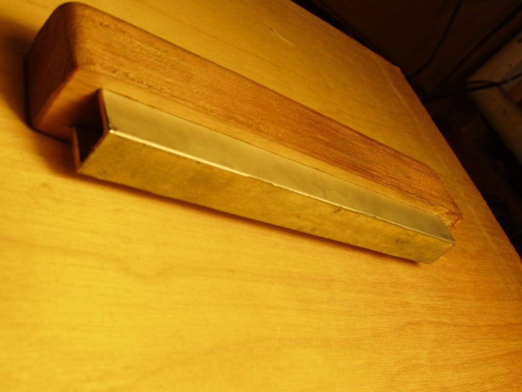

For the past 25 years or so, I've leveled frets with the strings in place and tuned to pitch and the neck pulled
perfectly flat with the truss rod.
I use a piece of 1"X1" angle stock from Home Depot or Lowe's with adhesive abrasive stuck to the outside
of one of the surfaces. This can be easily slid under the strings and used to level the frets in the playing
position and under the same tension that will be applied during play. I'll slide it under a pair of the strings at
a time and work my way across the fingerboard and then remove the strings to do the final crowning and
polishing. There are other builders and repair people who use this technique, but it was something that I'd
tried back in the early 80s in an effort to save myself time and some of the typical headaches of getting a
great fret leveling job done that would remain a great fret leveling job after the guitar was taken off of the
bench, tuned and played.

Right now I'm leveling under moderate truss rod tension then fretting which usually results in a fretboard that is close to flat with slight truss rod tension. With my carbon bar neck reinforcement and the LMI two way rod this has worked out well giving adequate relief at string-up. You can preview a rough idea of relief you'll get by supporting the headstock and putting 5 or 6 lbs of weight on each shoulder of the upper bout to mimic string tension. ( you can experiment on your own guitars to see how much weight gives the same relief as strung up with your standard gauge of strings)
I usually level the frets in this configuration (headstock supported and weight on the upper bout) and then touch up with the angle stock after strung up. It's an evolving process with me and this is where I am at this point in time.
Question for Kevin G: Do you use a nut extension with the angle stock leveling so the strings don't pinch at the upper end of the neck?

I used to use 1"X1" steel angle that was machined to bring the thickness of each leg down
to about .060" and flat to within .002" over its 16 inch length, but with the availability of nice
clean aluminum angle today, I've switched to that.

Just a note here to someone who may go out an buy a piece of 1x1 aluminum angle 16" long and expect it to be flat. the mill tolerance on extruded aluminum angle for flatness over 1' is +/-.045 per foot for aluminum extruded angle with flange thickness less than .250 thick. Some pieces will be very flat some will not. The friction heat involved in cold extrusion of aluminum is rapidly dissipated so it is usually pretty close to mid tolerance on flatness and always has a nice smooth surface but smoothness is not a reflection of flatness. It is best to treat the flanges like a new plane sole and true them up using sandpaper on a known flat surface if using long lenght like 16"
PostPosted: Wed Oct 22, 2008 10:33 am
Posts: 1041
Good point Michael. I should have mentioned that anytime you use a surface in an effort to
create a flat plain, it's essential that the surface bearing the abrasive is flat first.
I've learned over the years to never trust a tool to do exactly what it's intended to do before
I spend a little time with it and true it up or set it up.
Trusting them would be like unpacking your new jointer or other machine and expecting to
be able to just start it up and cut with it. It takes some set up and tweaking to get things ready.
Kevin Gallagher/Omega Guitars

I use 1/2" aluminum U-channel, bottom trued, under each string. I can get to the first fret with these.
I file ramps at each end, inside, so the wound strings don't catch an edge. Recently, I made a Q&D wood handle for them, better grip. I'll take a pic or two, post them later.
https://soundcloud.com/jeffreylsuits/he ... -runnin-13

Kevin,
Do you put a handle on the thing ? 1" doesn't seem like much to grab on to. I am thinking that you are pretty close to where you want to be and this is a fine tune type of thing ? I would imagine you are getting feedback from the scratches being 90° to the scratches from the leveling that I assume you do lengthwise before adding the nut and strings. Anyone put blueing on the frets to better see whats going on.

The U-channel leveling tool & handle.
I also use an appr. 2" for spot leveling, have longer ones but rarely use them, the 3 four inchers are the workhorses.

Very nice Yundev. If you guys are leveling a straight radius fretboard with the strings at tension I assume you move your device parallel to the center line of the board. Do you ever try to get a compound radius effect on a straight radius board by leveling in line with the strings using the L or U channel devices?
Terry
PostPosted: Wed Oct 22, 2008 11:23 pm
Joined: Fri Feb 29, 2008 2:41 pm
Posts: 312
Terry
Thank you--this method, using U-channel, I remember reading about in a Big Red Book, the luthier's name was Bishop Cochran. I had also used the L-stock, but found this to be much faster; I made the handle because of my problematic wrists.
I run under the lie of each string, and move back & forth enough to blend across the top of the frets; I suppose that becomes a sort of de-facto compound radius.
The instrument IS the "neck jig", with this method--you're dealing with the real world, not a virtual, jigged-up one.
