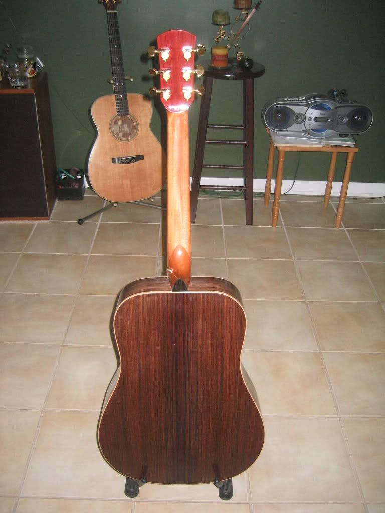

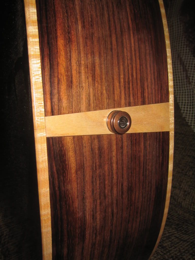

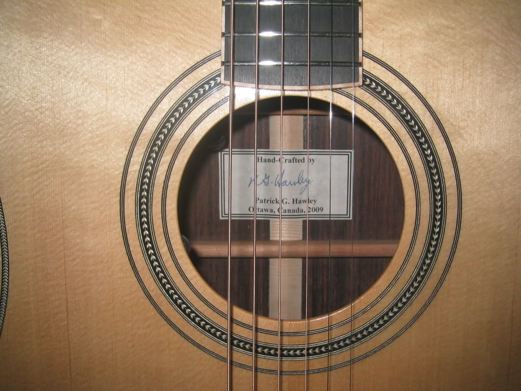

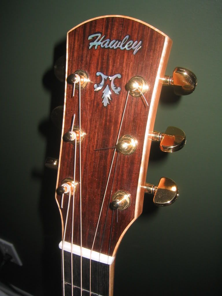

Just finished up number eight this morning. This one is for my nephew. The top is sitka spruce and the back and sides are east indian rosewood. The back of the head is a bloodwood veneer. The thing l like best about it are the bindings which are curly maple. They were tough to put in though, my thumbs hurt for days after from pressing them in to place.
The finish is my first try with Tru-Oil. As a finish, I can see that it has potential and I'm definitely willing to use it again. It feels great on the neck. To me, it doesn't seem any harder than shellac but I guess it has more resistance to water and alcohol. Overall, in my opinion it doesn't quite match the beauty of French polished shellac but I may be premature with that judgment.
It sounds good. My nephew wanted to be able to plug it in so I installed an LR Baggs I-beam.

Pat, what sort of strap button / jack socket is that? In the photo it looks to have a sort of bronze colour. Much nicer than chrome.

Thanks for the comment Chris.
Dave, the strap button/jack socket is a bronze colour and it's just what came with the I-beam. It's what they happened to have in the store at the time I was buying. I agree, it does look nicer than chrome (which I've also gotten with an I-beam).
