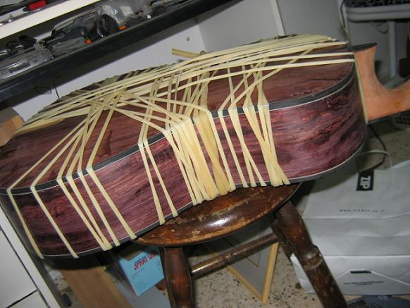

lee valley has something similar.
i've been using it for about 2 years now without any problems.
Udi.
