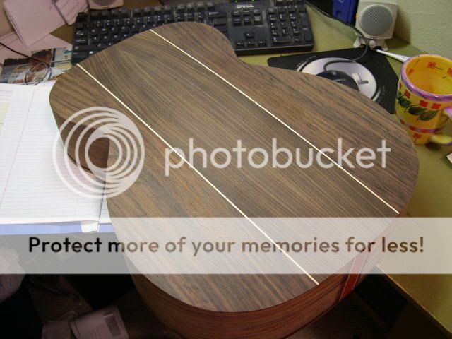

I just finished assembling a soundbox on an OM'ish steel string....no binding yet...and not finish sanded yet. It doesn't have glue all over it either. The top is Western Red Cedar. Back and sides are East Indian Rosewood. Bracewood is spruce for everything. The depth is just shy of 4.250 at the tail block and 3.562 at the neck block. Soundhole is just shy of 4 inches...3.90.
Currently the main air resonance of the box is 25 cent to the flat side of A.
I am attempting to bring the main air resonance down. My perception, and bear in mind that I have absolutely NOTHING to base this on, is that it's too high. My last 2 guitars were between G and G#. They had spruce tops though.
So....any ideas?

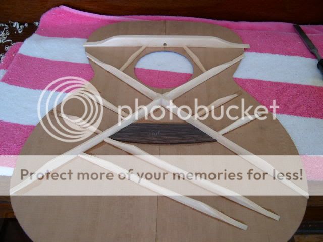

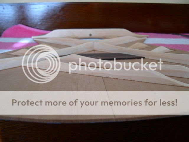

I think it would be a good idea to put up some pics and add some data for some of the internal components.
Here's the top.
Tonebars - lowest valley is .360 (.258 wide when installed)
Lower X Brace arms - lowest valley is .470 (.235 wide when installed)
Top thickness is .115 -.119 depending on where you measure
Bridge Plate is EIR @ 90 thou
I don't have a photo of the bracing of the back bracing but there are 3 cross grain supports where joints meet - It's a 6 piece back - Here's a photo of the outside.
The two lower braces of the back started at .252 wide x .705 tall
I forgot to record the upper braces but I can tell you they are wider but not as tall.
Previous to posting this I worked the top bracing down a tad farther with an Ibex finger plane. Where the main air resonance was EXACTLY A before.....the main air resonance dropped almost 30 cent (headed towards G#) after the carving. A good estimate for the amount I took off the braces for the top would about 75 thou off the height off all the valleys and the peaks of the finger braces. I don't think I want to go too much farther because the x brace was installed at less than 250 thou wide.

As an inexperienced noob, it looks to me like you could move the "tapered part" or the peaks of the X-braces a bit more to the center, perhaps 1/4 to 1/2". That should loosen the top a bit and drop the top mode some. Not sure how the interactions with the air mode are so obviously YMMV.
I base this thought on looking through some pictures of bracing of my own guitar and others I've seen here and elsewhere (just googled some and checked). Perhaps a thread where people post their bracing would be nice to have eh?

My back braces are never taller than .590, maybe something to chop down on yours.
