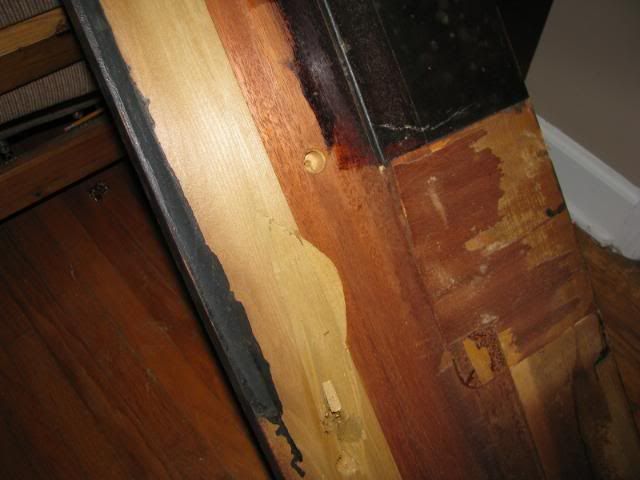

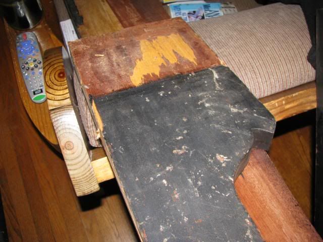

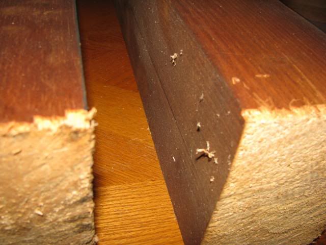

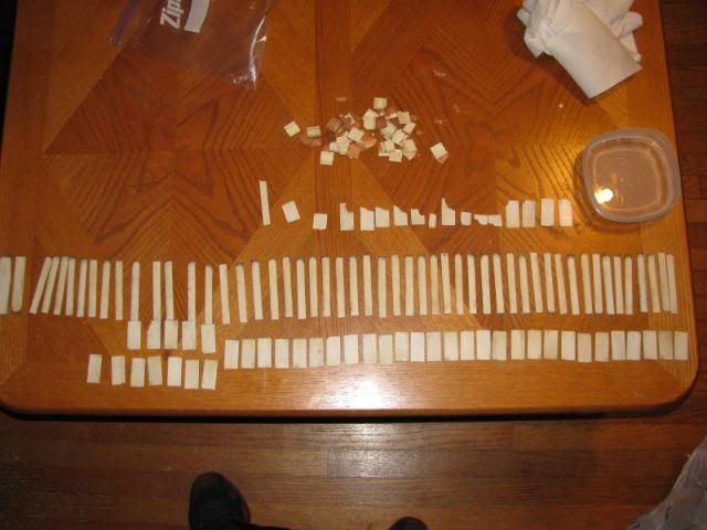

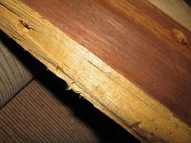

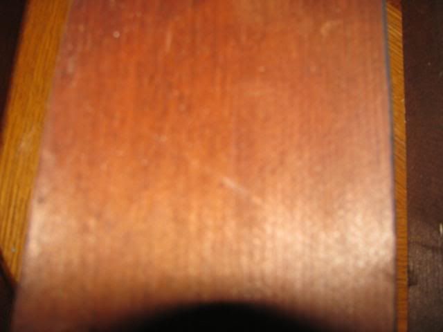

Hi forum. I am a very amateur and aspiring luthier. Yester day I picked up a piano that is supposedly made of Honduran mahogany. The piano is 115 years old. So I figured why not harvest the wood and build guitars with. Well after getting as much wood as possible It seems that not all of the wood is the same. I did however obtain much ivory to use as fret board inlay. I also obtained some ebony that I am going to make bridge pins with for an acoustic build. Any suggestions as to what to do with the ebony sharp keys would be cool. I would like for the members of this forum to help identify this wood before it goes to get sawed.
PS, This forum is awesome!!!
Ivory overview
Ivory close up
Some pics of the wood

I am almost sure that the first pieces are veneer. But I have never dealt with raw Honduran before. Any help is appreciated.

It looks like poplar with a veneer to me... But I am no expert. I would guess the keys are going to be the best part of the score.

To ID the solid wood (aside from the poplar under the veneer) you really need to show folks what the surface of the board looks like, without finish. (So some sanding/scraping is in order.) Furniture (and piano) builders were/are quite skilled at making one wood mimic another, by staining and finishing.
Did you take the soundboard from the piano? Sometimes these are good tonewood...
PS- the ebony might be useful to somebody who makes wooden pens on their lathe.

The black keys (sharps/flats) were often Pear wood (Swiss Pear), dyed. You'll have to cut through one to know for sure, although the density of Ebony is a lot higher than Pearwood.
Not to be a stick in the mud, but remember that you probably cannot legally export the ivory without massive hassle on your end, trying to get it documented.

Good score. I came across a similar treasure a couple years ago. The ivory might be a little thin as is but is easily laminated and will be great for inlays.

It doesn't appear to be an expensive piano so what appears to be ebony
for the incidental keys probably isn't.
I doubt there is any mahogany in it other than veneer. Usually the case would be oak
with a poplar substrate below the show veneer.
On grands the lid will sometimes be mahogany but more often than not, it's spanish cedar over which
you'll likely find a cross band of poplar than the show veneer.
Unfortunately, the spruce you'll most often find in a piano will not be appropriate for a guitar. The grain will be quite wide and the wood much less stiff on a piano. Not only that, but a soundboard for a piano is glued up of fairly narrow boards,
most of which that won't be wide enough for half a guitar.
Sorry for all the bad news but you might as well hear it before you spend alot of time cutting into a piano.

But... you have a lot of beautiful Ivory nuts and saddles, a lot of stock for beautiful ivory inlays, beautiful ivory fingerboard dots... Just for that, that's a good deal!
