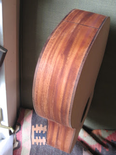

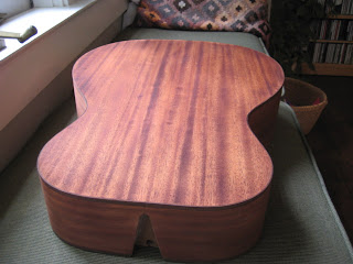

Have I really been working on this guitar for over 6 months?
Now that I finally got the binding on, I went back on my own earlier decision (this guitar is for a friend) and resumed the plan to dye/stain it.
The plan was to make something a lot like a 30's Martin 00-17. None of those were not stained, as far as I know. So that is the reasoning.
So, here's what I concluded after conducting dozens of tests on offcut pieces.
It was difficult to get an even application of color using transtint dyes diluted in alcohol. Putting the dye/alcohol mix directly on bare wood does not work at all! Sealing the wood first with shellac helps, but then the color was still difficult to keep even.
At first I was concerned about how the transtint-dye-diluted-with-distilled-water warped my test pieces. but I liked the even application, and the ability to use a very weak mixture and apply lots of coats to get a more exact color.
So then I tried Minwax stain. Red mahogany. This was very easy to use, and the color went on evenly. I didn't like the oily texture, and was wondering about how shellac would stick to it. A drawback to using it was that once I put it on, it was done. I wanted to be able to tweak the shade once on the guitar, so I went with transtint dyes.
So, I proceeded on the guitar using dye diluted with distilled water. I used transtint red mahogany and transtint brown mahogany. similar to the Martin process, I stained with red first, then brown.
I applied the 2 dye colors over about 2 days. First I did the back, then the sides. I then used a wet tshirt to wipe the whole thing down to lighten and even out the appearance.
The sunlight makes it look a little more red than it really is. But I do like the redness. I was going for a look like this: http://www.guitarrez.com/newpics/sc2900cu.jpg
Next I'll do the top.
Question. Should I just stain the whole top and then proceed with french polish? When it gets time to glue the FB and bridge, use a razor blade to scrape those areas clean?
-OR- ... should I be worried about glue sticking to dye...and mask those areas now?

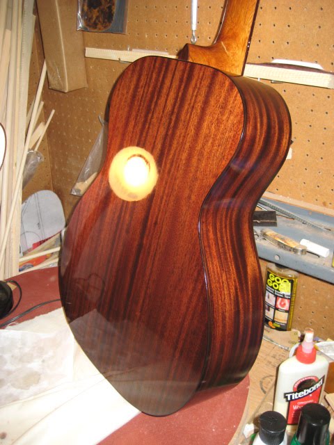

I masked it.
I'm pleased with how it's turning out.
"...you have to get over your strict adherence to your largely imagined notion of absolute perfection..."
PostPosted: Mon Jun 28, 2010 8:59 am
Joined: Tue Mar 17, 2009 10:22 am
Posts: 393
First name: Martin
Last Name: Lane
City: Grand Rapids
Success.
i've been working on the finish of this guitar for over 2 months. i've discovered you have to hit on just the right mixture of wetness, alcohol content, shellac content, shellac cut, amount of oil, and use a new cover each time, to get the surface just right. i'm still not exactly sure how to engineer that result 100%, so i keep trying each night until i get lucky. it's definitely not for everyone.
late in the process, I glued the neck on. for the glazing process, I can work on the top, hang it up, then work on the back while the guitar is hanging there, and then do the neck.

PostPosted: Mon Jun 28, 2010 12:49 pm
Joined: Tue Aug 19, 2008 12:17 pm
Posts: 534
Martin that turned out beautiful! [clap]
After seeking all the info you can get, you just have to jump in there and see what happens.
You did a great job,

Wow!!! That looks great Martin! [clap] [clap] [clap] I'll bet you are satisfied. Looks like you sure put some time into it.
PostPosted: Mon Jun 28, 2010 10:34 pm
Posts: 393
First name: Martin
Last Name: Lane
City: Grand Rapids
Thanks! After this epic first time, I wasn't sure how long it would be before I felt like doing another finish. But then my wife informed me that at least the next dozen are going to go to Joe...
