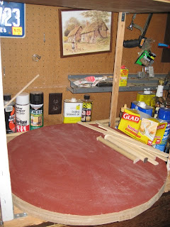

Here is mine, although its a bit cluttered at the moment. I built it into the end of my bench, and the top serves as a shelf. I bought fiberglass rods from goodwinds.com
