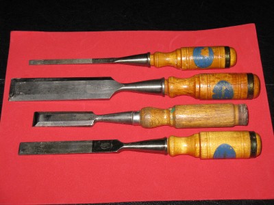

Well get a set of Berg, Erik/Eskilstuna, Sweden : "Shark" Chisels. Sockets not the tangs with boxwood handles...thats if you can find a set at a reasonable price in North America...They are still easily enough found in Europe, and on ebay ...sometimes sold as collectors and others as just an old chisel. Been out of production for many a year now (1950). At least the socket handles are, the tang type are still made but take a pass on the tang type. Junk stores, flea markets and garage sales. Often found with out handles.
they look like this. One of the handles is not original. The logo E.A. Berg. is etched onto the metal with the name, 'Eskilstuna', and a picture of a shark below. Some times a shark and an anchor is used.
I have or had a full set from 1/4 to 2 inch untill the 5/8s grew legs. Have used all sorts of chisels , but like these the best.
