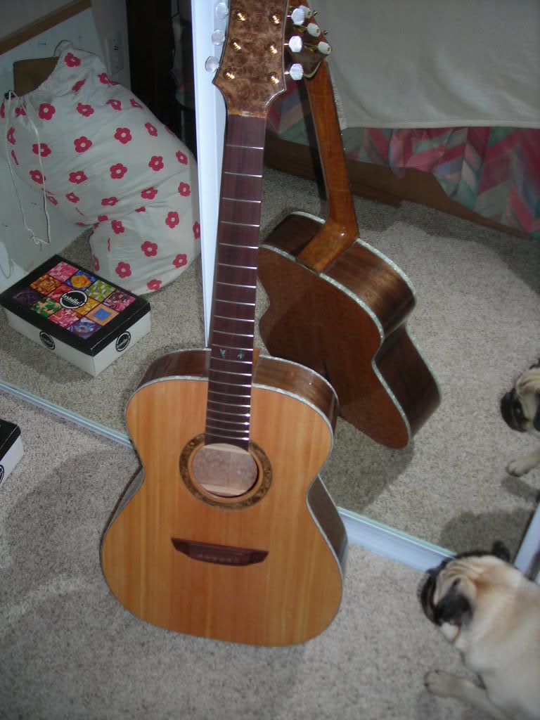

I'm pretty new here. 24 years old, almost done with build #1! Got the tuners on tonight to complete the look (almost). It's been almost 4 months since I started this build, working here and there and on weekends and I couldn't help but take pictures.
The guitar is based off of Alex Willis's plans for an OM. (Set neck [never again])
There's still a little buffing compound around the neck and soundport that really showed up in the pics- which don't do it justice. I think it turned out pretty swell.
:( Gotoh tuners. Sorry the image is blurry
2 fly inlays @ 12th fret

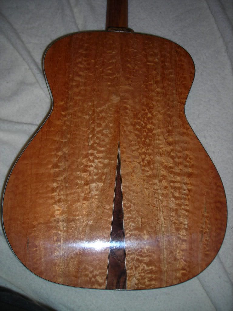

Oops, missed this angle completely. The two tone back and sides always looks weird to me in pictures. The design is much more appealing to me in person but I probaby won't ever mix and match again (or use non-wood bindings).

Hi, congrats, that's looking really good - I like your "scheme", headstock plate and backplate, 3 piece back, pearloid(?) binding. Kind of mix'n match, but it goes well together. Kind of like a patchwork quilt if you don't mind me saying so - it's meant as a compliment!
Nicely done.

Excellent work, I love the sound port :) And only 4 months? I've been working on mine for over 6, and still not done yet... and you're even 2 years younger. Way to go!
