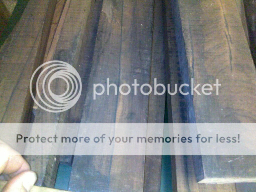

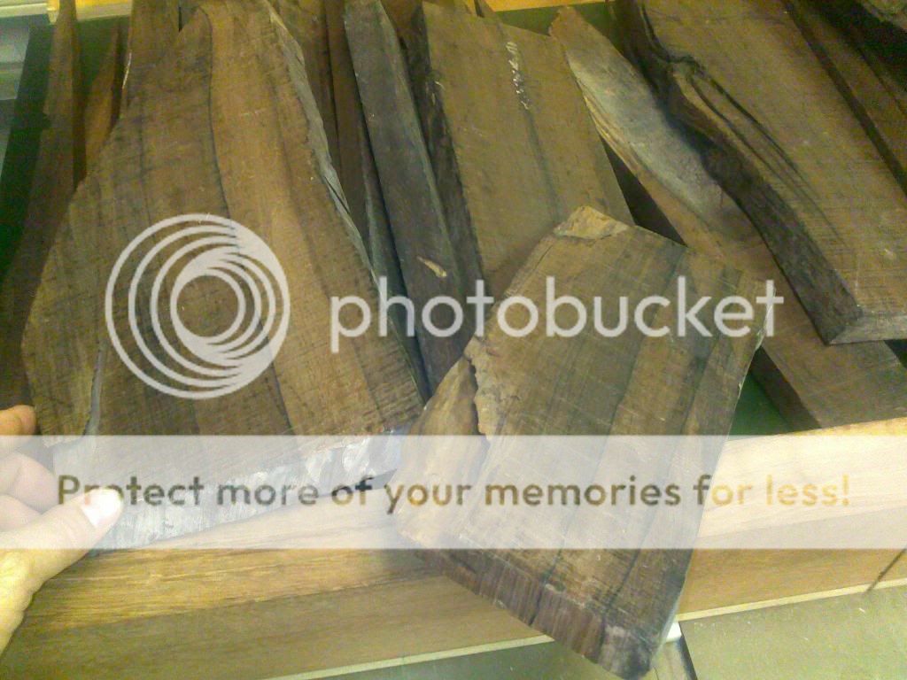

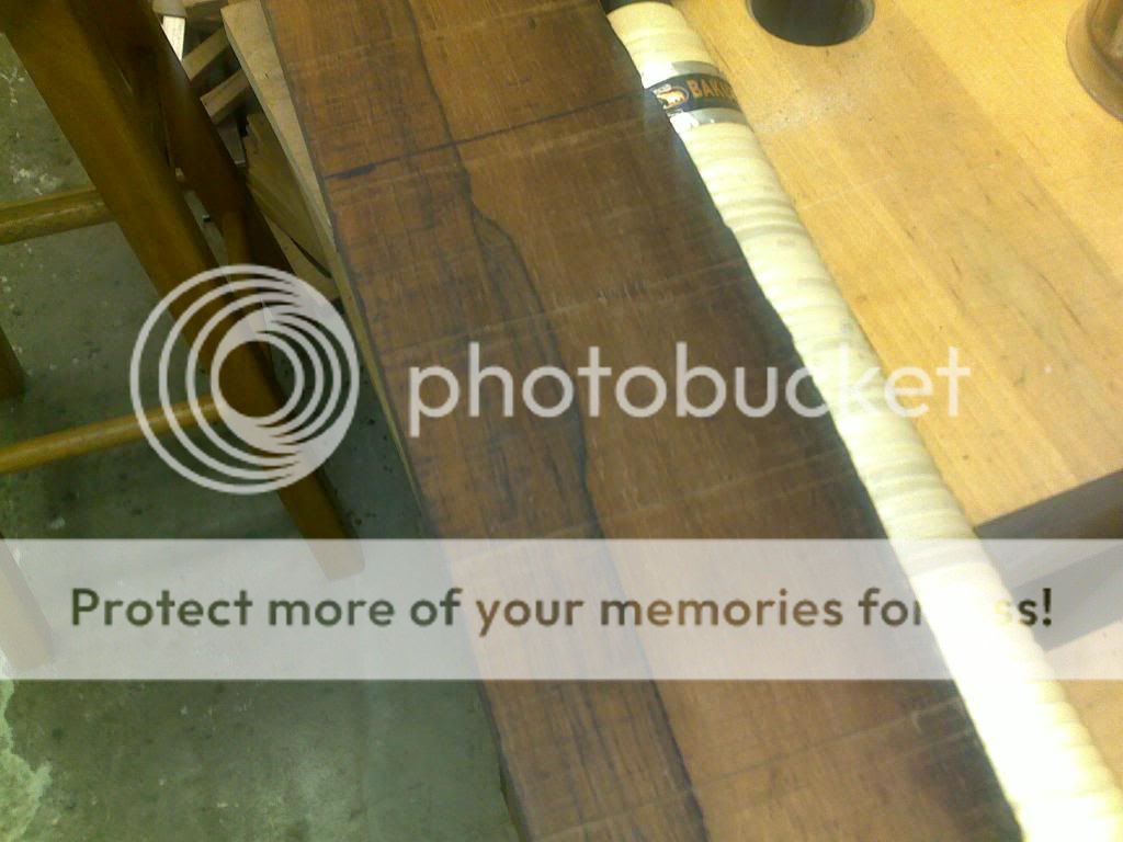

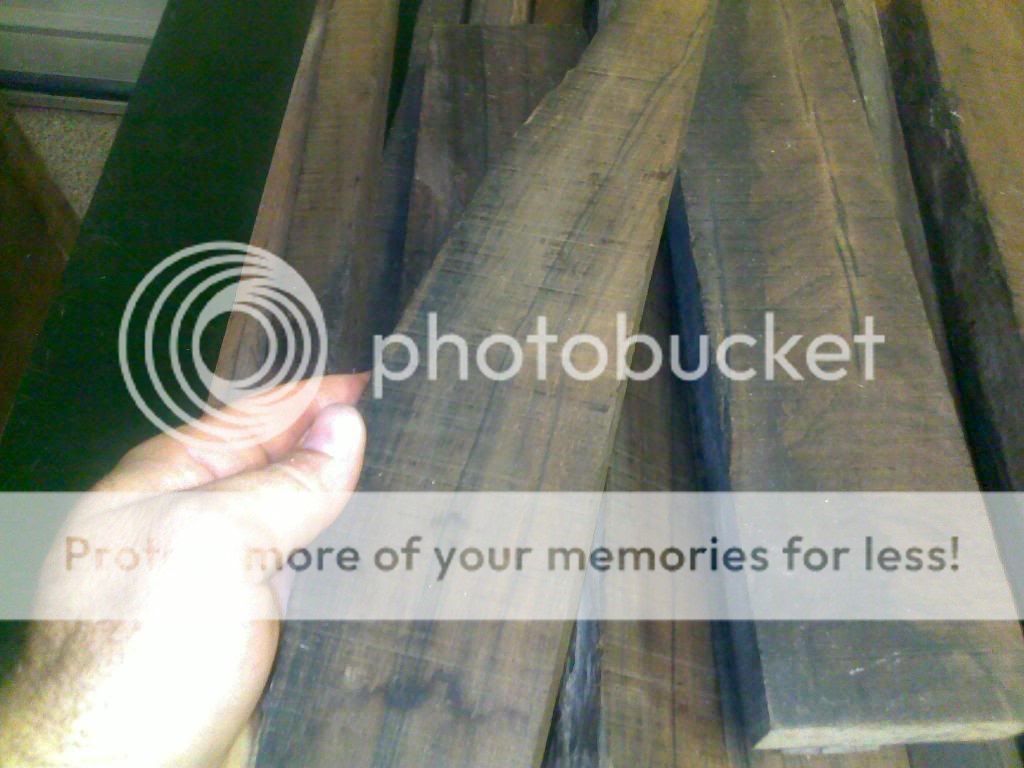

So here are the pics:
Here are the two bins of cutoffs
Here's a piece I just grabbed and wiped with a wet rag
Sorting through it all...not cleaned up yet
Can you say fingerboards??
All cleaned up...most of it anyway
Here are my concerns / questions:
I don't have the idea in my head that this will happen regularly...to me anyway. Consequently I need to make the MOST out of this. Admittedly most of this will be processed to suit my needs. Some of it will be processed for sale at a later date. THIS ISN'T A SOLICITATION FOR BUYERS!!!!!! I need 2 pieces of dimensional information from as many people as possible INCLUDING CLASSICAL BUILDERS.
1. What's the final dimensions of your bridges?
2. What's the final dimensions of your headstock overlays?
I'm hoping to get some input from all the different builder types out there.
Thanks for reading and thanks for the input!!!
