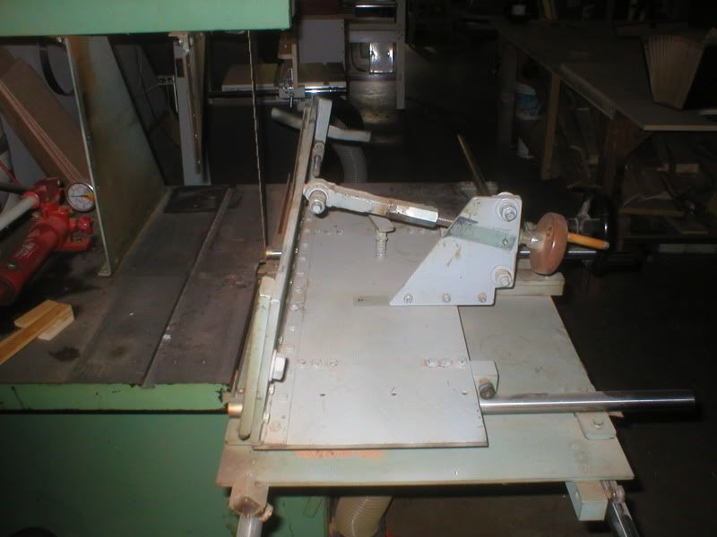

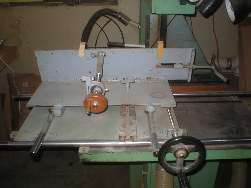

Don't know if these will be helpful, but you might get some ideas...
The first two pics are of my big saw. It has a rolling table which grips a top billet & tilts to get right on vertical grain. The table advances with the large black wheel & the thickness of cut is read on a dial indicator. (removed at the moment) Tilt is controlled with the small wooden wheel.
