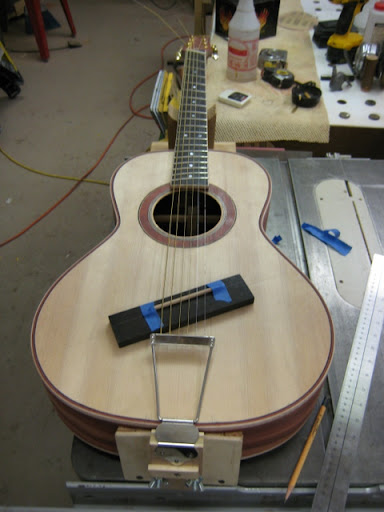

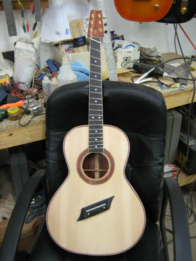

Here is the way I do it.

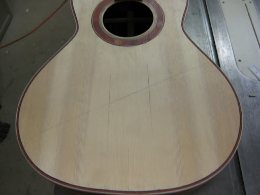

The diagonal line is the mathematical measurement for placing the saddle.
The verticle lines are the width the saddle
needs to be plus an 1/8"on either side.

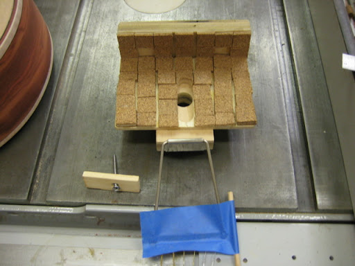

The locating jig with strings loaded in the trapeze tailpiece. The dowell is a 3/16" Note the block of
wood with a screw in it.

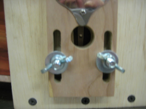

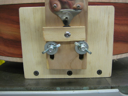

The jig just resting on the lower bout.The hole is centered to receive the block of wood with the screw in it. The slotted piece has the trapeze tailpiece mounted on it. The wing nuts allow it to be adjusted for thicker sides or thinner sides.
The block of wood with the screw tightened
to prevent the jig from moving.Image

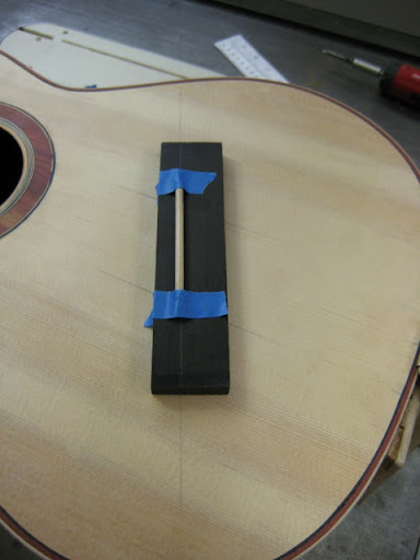

3/16" dowel taped along the saddle line.
Strings installed and tuned to pitch.
Note the top nut has been notched for
correct spacing not finalized to depth.
Next will be to strobe tune the saddle
to place it exactly where it needs to
be by moving the entire bridge and saddle.
before taping underneath the contoured
bridge (that I have yet to do) and drilling
the bridge pin holes for the two "E"
strings. These two holes will guarantee
perfect alignment both left and right and
up and down. Also near perfect intonation
when it's time to glue it down permanently./16" dowel taped along the saddle line.
It's about ready to disassemble
and seal and start shooting nitrocellulose.
"Try to be the person your dog thinks you are."

One thing which needs to be emphasised is that if you are setting your saddle position by testing using a tailpiece or with the stemac inotator, your string height needs to be at final playing height. Too high and you will end up with excess compensation and your saddle too far back for the final setup.
PostPosted: Tue Jul 27, 2010 9:21 pm
Joined: Sat Feb 20, 2010 8:49 am
Posts: 110
First name: Bert
City: Gainesville
State: GA
Zip/Postal Code: 30506
Jeff I use different diameter dowels. This one took a 3/16" on others I've used 1/8" even tooth picks to get the action set at final playing height. I correct the bridge height based on what thickness dowel I use.
