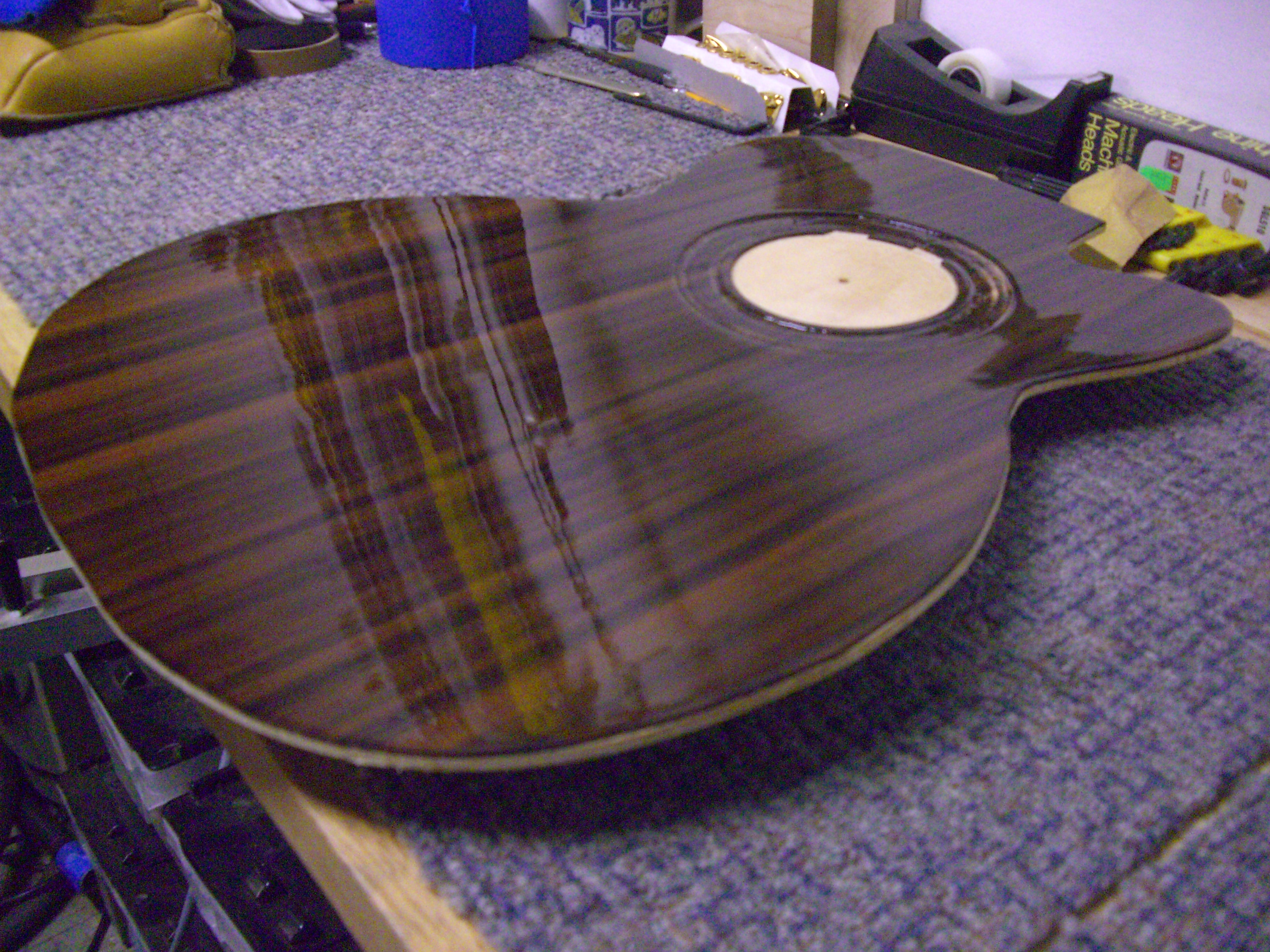

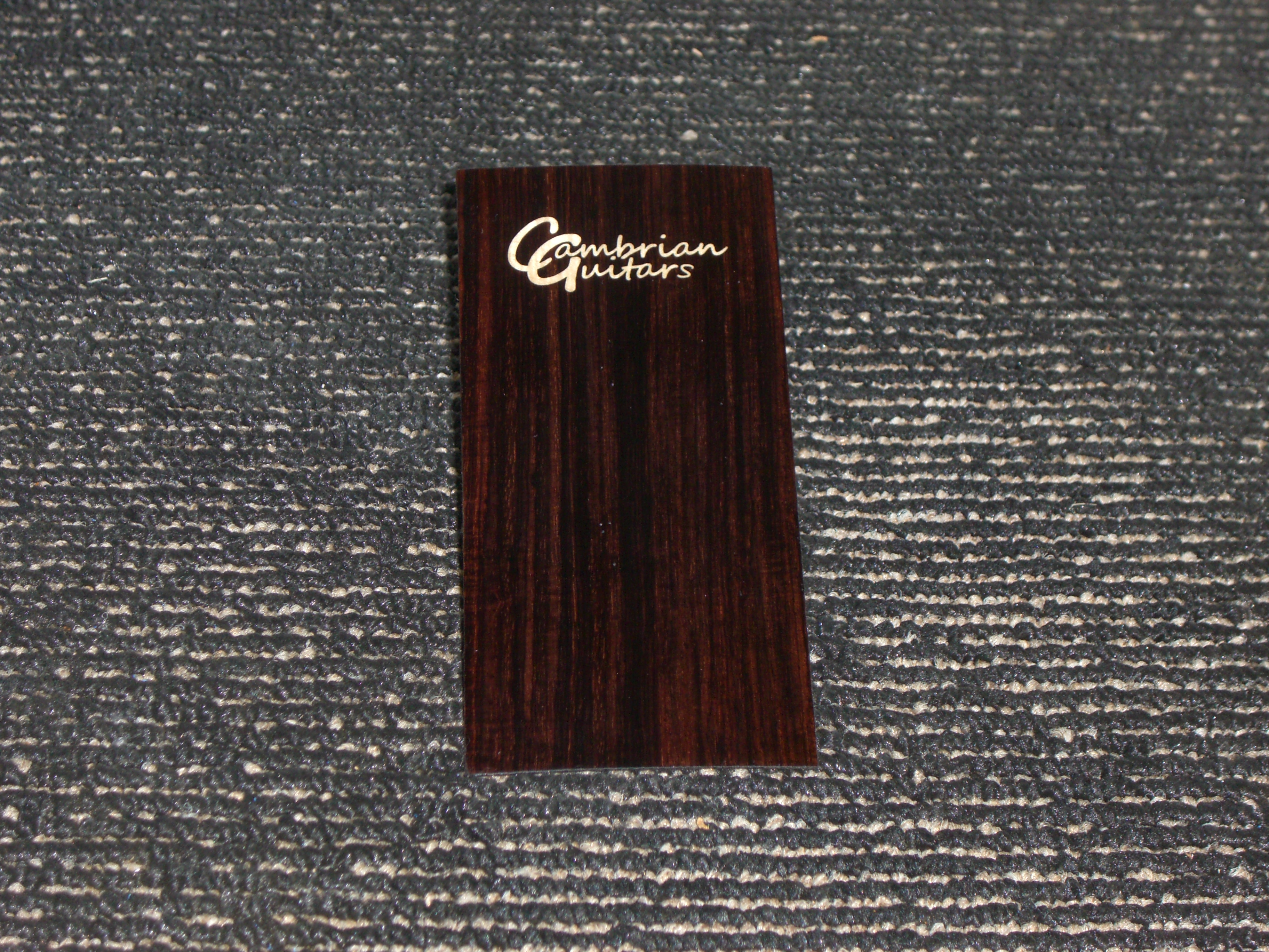

Pat, I don't have any pictures of the marquetry pieces, sorry (I had to rush them out for people's Christmas presents and never got time).

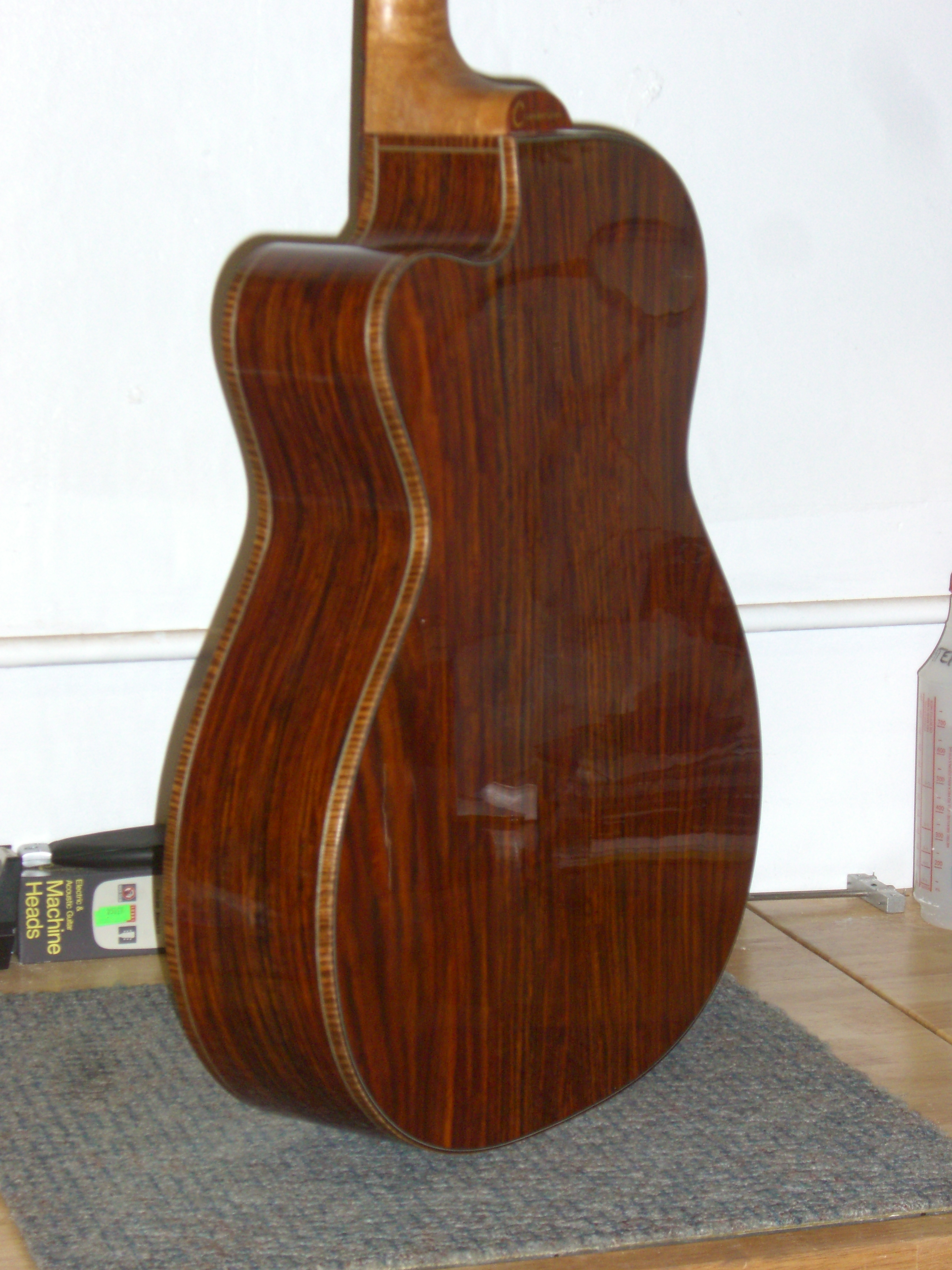

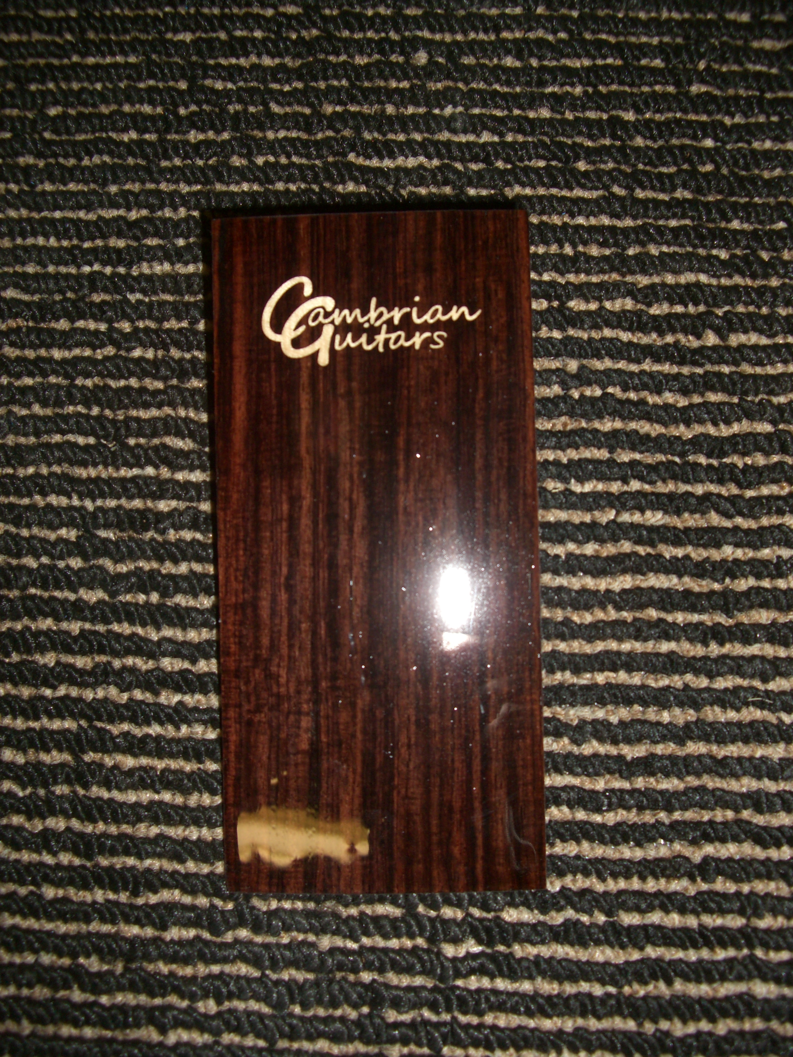

My new hand-held UV lamp unit arrived from cureuv.com today. I gave it a test run on a EIRW headplate with maple logo inlay. Here are some photos:
The finish is really difficult to photograph.....best I can do is a) show it dead on so you can see it's clear, and flat/even, and b) show it with some lamp reflection. If you look really closely at the photo with the light reflection, you can see me with my camera on a tripod mirrored in the finish!
The procedure I used was as follows:
1. Sand to 320 grit
2. Wipe on a thin layer of insulator/sealer and set it aside to dry for 15 minutes
3. Wipe on a thin layer of gel filler
4. UV cure it - ran the lamp over it slowly - about a 5 second pass -> cured!
5. Lightly sand with 320 grit
6. Repeat 3, 4, 5, and 6 above (another gel filler coat)
7. HVLP spray a thin topcoat and leave it for 5 minutes (spreads out nice and flat in this time)
8. UV cure it - ran the lamp over it slowly - about a 5 second pass -> cured!
9. Lightly sand with 320 grit
10. Repeat 7 and 8 but with a slightly heavier topcoat
11. Stand back and admire
The result is an almost flawless finish, nice and hard and very shiny and clear. The only issue was that I didn't really spend time to clean up properly after the light sanding between coats and so ended up with a few nibs in the finish. I think a wipe over with DNA (is this okay I wonder? - I will call John, the apps guy at cureuv.com and find out) after each sanding is called for.
I think it will look even better after some polishing on the wheels with Menzerna.

I played some more with the UV finish and I think I have it down. The new handheld lamp from cureuv.com seems to be the way to go - it cures in seconds and doesn't heat the work up too much at all.
I tried it on a scrap soundboard that I had - sadly, this was a primo sinker top that crumbled and split on me at 0.115" :( I glued it to a sitka top in the hopes of maybe using it one day, but the darned thing warped uncontrollably and split some more, so I gave up on it. It made a nice test piece for the cureuv finish though.
I used the same procedure as before - one coat of sealer (not really needed unless the wood is "oily"), two coats of gel filler, two top coats.
This time out I took care to filter the top coat into the HVLP cup. I used a Husky Pro (HDS series) gravity feed HVLP conversion gun ($99 from Home Depot) rather than my big Turbinaire HVLP system. I used the small cup that came with it. I have the air input set to 38psi (just under the 40psi mark). I set the air feed to about the 50% level and adjusted the fluid to suit. I goes on nicely, but it gets up your nose quite a bit - I'm going to use a mask with this stuff from now on.
The gel filler coats and top coats sand nicely. They are rock hard. Sanding (at 320 grit) produces dust only. It doesn't clog and/or ball up like the waterbourne stuff I've used before. It's much harder than any other finish I've ever used, so I found myself having to push the sanding quite a bit harder than I've ever had to - there was no chance of sanding through though....it seems quite safe/immune from that problem! Here's a picture showing the sanding in progress after one of the gel filler coats:

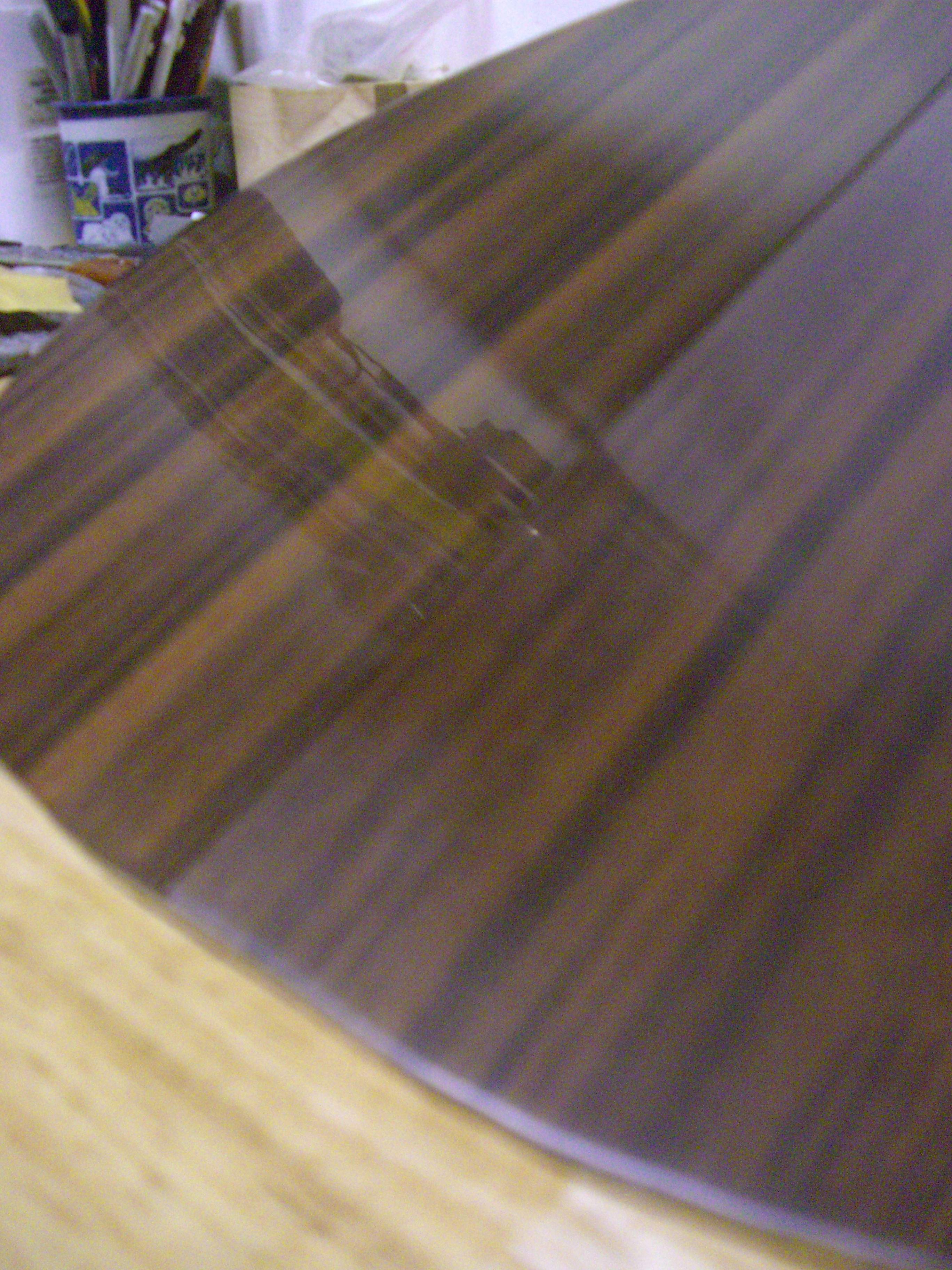

Here's the top right after curing the second top coat. It's a nice mirror finish (you can see the reflection of some bench/tools in it nicely), however there are nubs in the surface where dust got on the work. I really need to make a clean room/booth for spraying/finishing!
I flat sanded it (using water and wet/dry from 400 to 2500 grit), then used Menzerna "very fine" and "finest" on the buffer. Just as I was pulling the work off to put some more Menzerna on (a momentry lapse of concentration) BAM!, the buffer grabbed the top from me and slammed it into the floor! Split it right down the middle (interestingly, NOT on the glue line at all!). I super-glued it together again as best I could and then finished polishing it. Here's the final photo. It's not as shiny as it could be, I'm sure, but the finish is (IMHO) excellent.
I hope I covered all the questions you guys had - let me know if I missed any points or if you have any new questions.

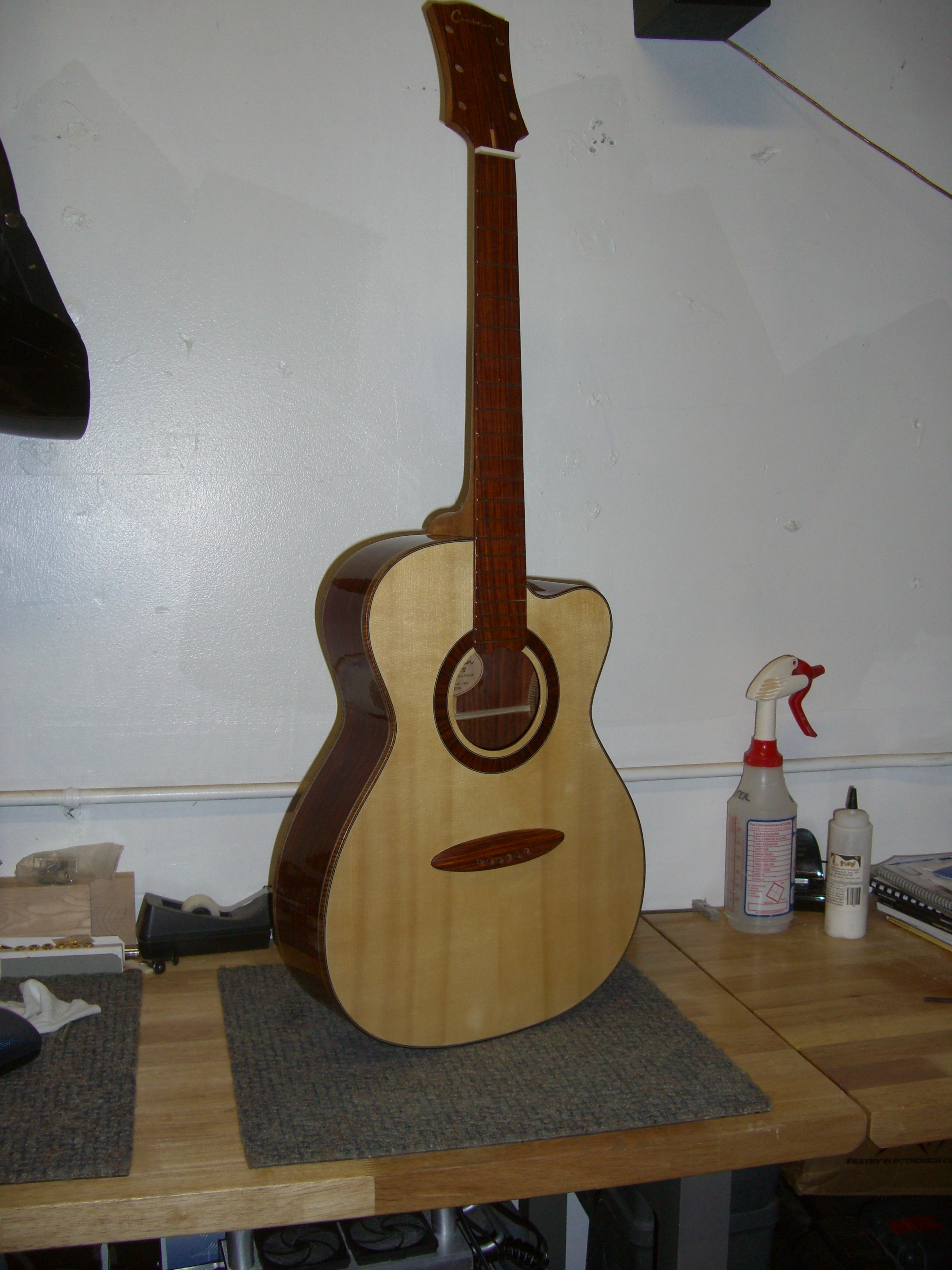

Pat - I sprayed and cured the guitar late Sat eve without any issues. The topcoat clings quite well to the vertical surfaces (the sides in my case, since I spray the back and front flat - with the work in a pattern maker's vise). After spraying, I left the top coat about 10 minutes for it to flow/flatten by itself before UV curing it. There were a couple of drips from the sides, but they did not present a problem. I would think that you could brush the top coat on, but it's going to be much harder to get an even thickness and keep it all nice and flat. You should invest in a small compressor and a $99 HVLP conversion gun IMO.
Josh H wrote:
Do you have any idea what you final finish thickness is? Just wondering how it compares to what people are getting with Nitro or other types of finish.
Josh
Josh - After spraying and curing the top coat, the finish thickness is between 0.005" and 0.007" - I measured it at the bridge and fretboard extension masked-off areas after I removed the masking tape. I think this is a tiny bit thicker than people aim for with nitro. I'm not a finishing expert by any means though - perhaps someone else with more knowledge can chime in? After flat sanding and polishing I think it will end up at about 0.004". I'll remeasure and post the result later. One positive note - it didn't seem to make much difference to the tap tone of the guitar I just did.

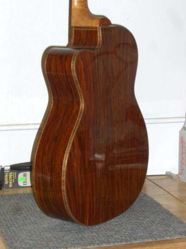

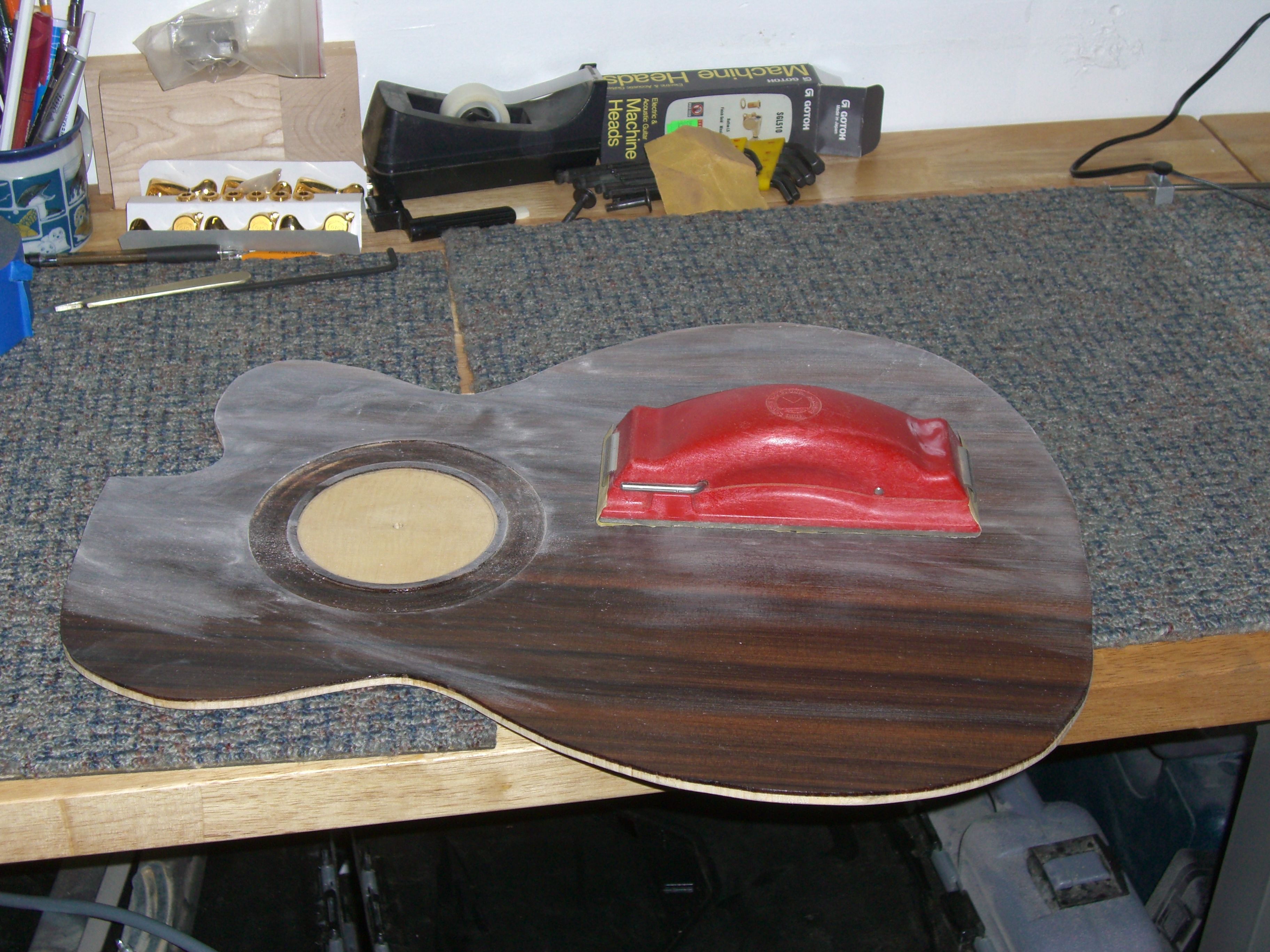

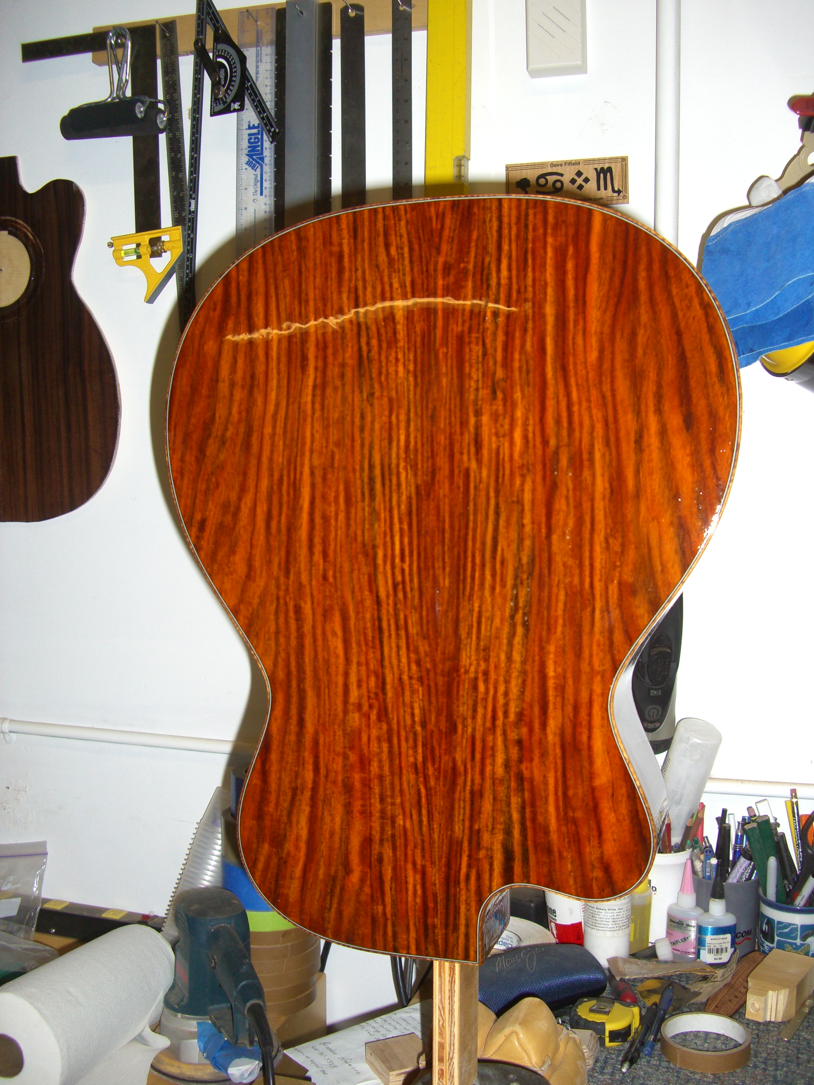

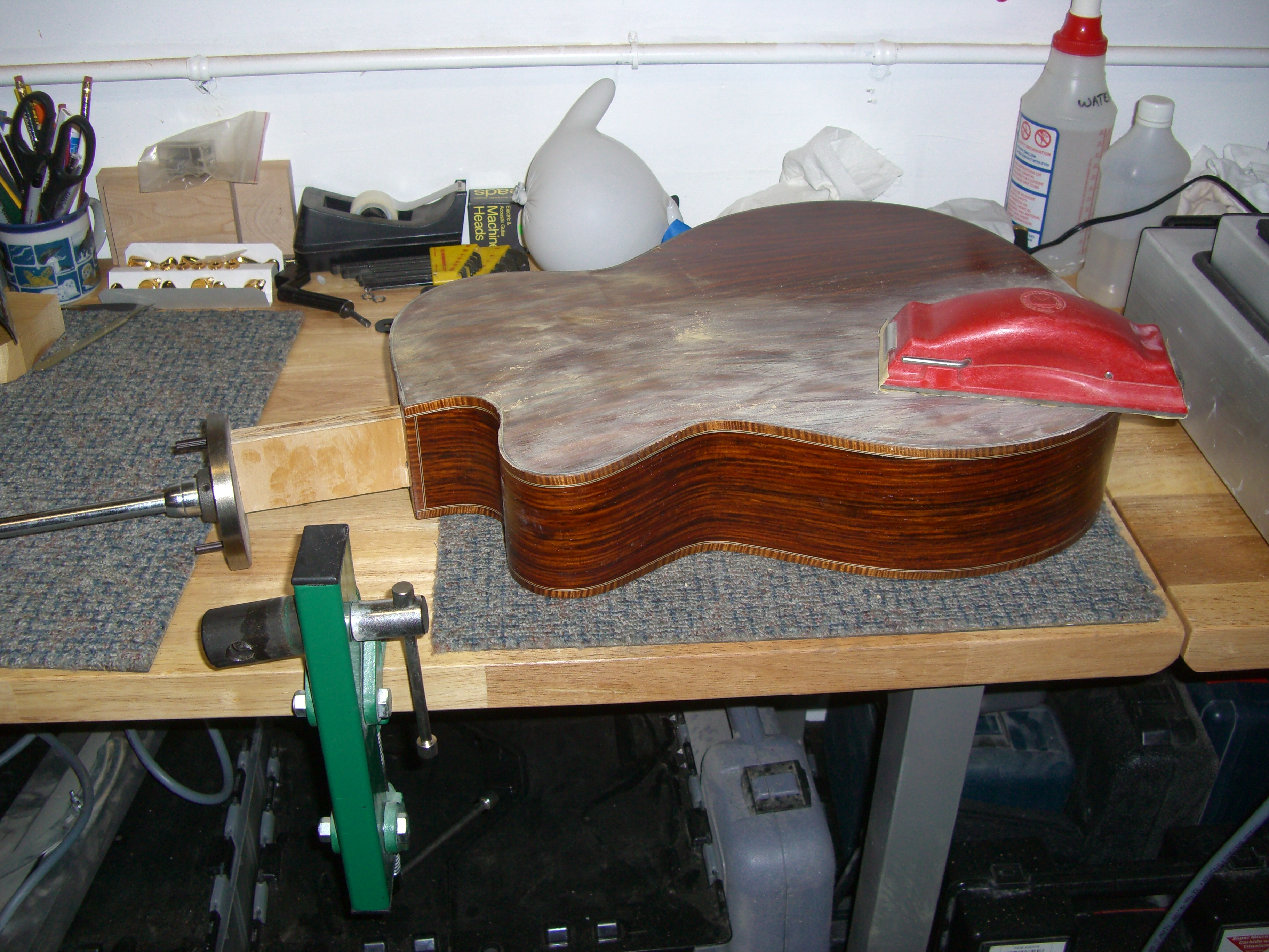

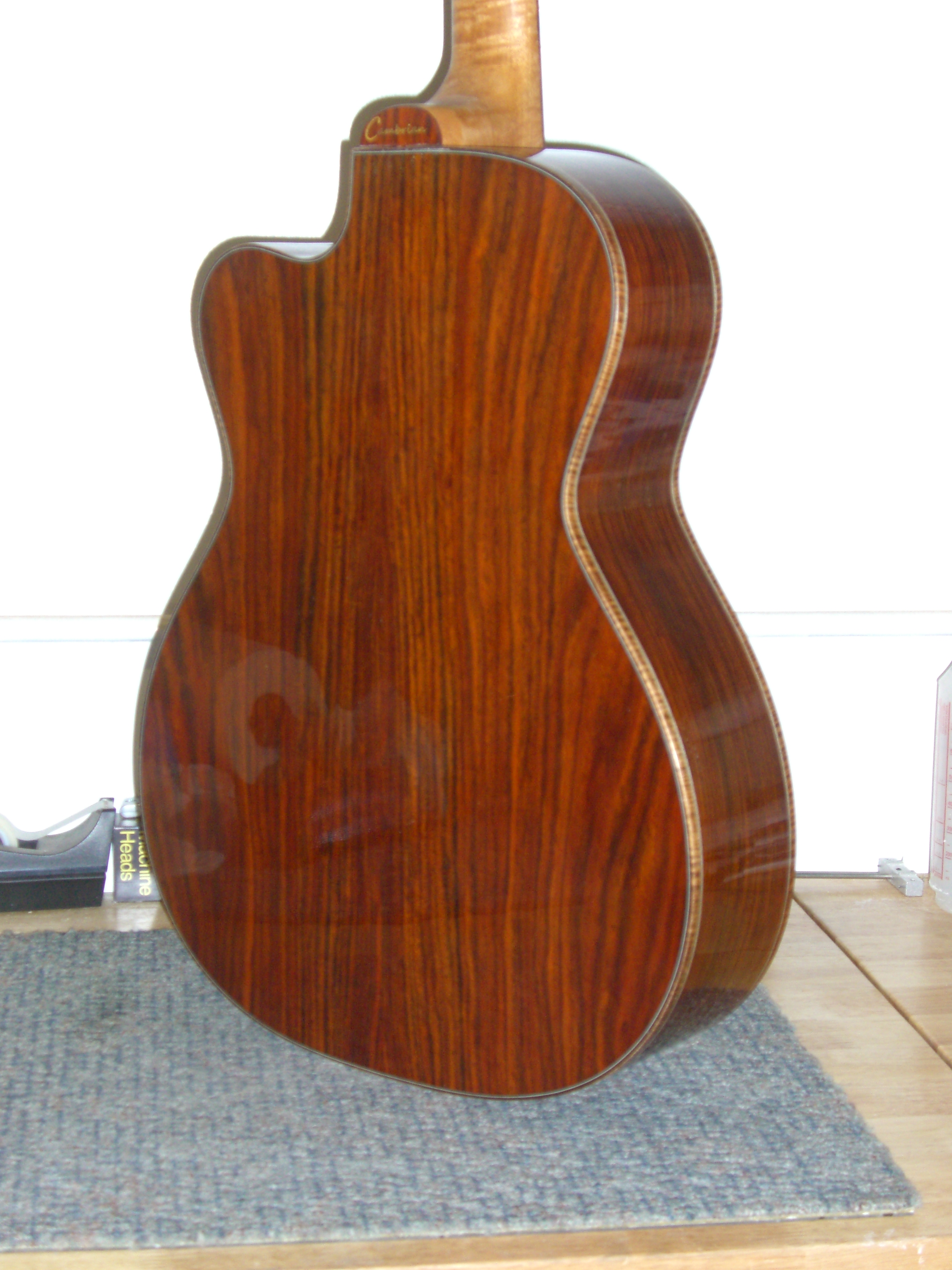

Here we go....the proof of the pudding is in the eating.....I sanded and polished my coco OMC this evening. It came up beautifully. There's no way the finish could be described as "satin".....it's high mirror shine for sure! I'm very happy with how it came out, especially the clearness of the finish (no blue tinge like the waterbourne stuff). The final finish depth ended up a bit thinner than I thought it would..... it is right on 3 mil (0.003") average. The guitar taps very nicely and sounds almost exactly the same as it did before the finish was added. Here are some photos:
Light sanding between coats:
After curing the last finish coat. You can see it's very shiny, but not flat, and with a few nubs in it:
Here's the front view after finish sanding and polishing ( I perched the neck on and used tape to hold the bridge in place for the photo):
Here are a couple of shots of the back/sides:
Cheers,
Dave F.
Cambrian Guitars

Looks great Dave. Thanks again for sharing your experience.
Pat
