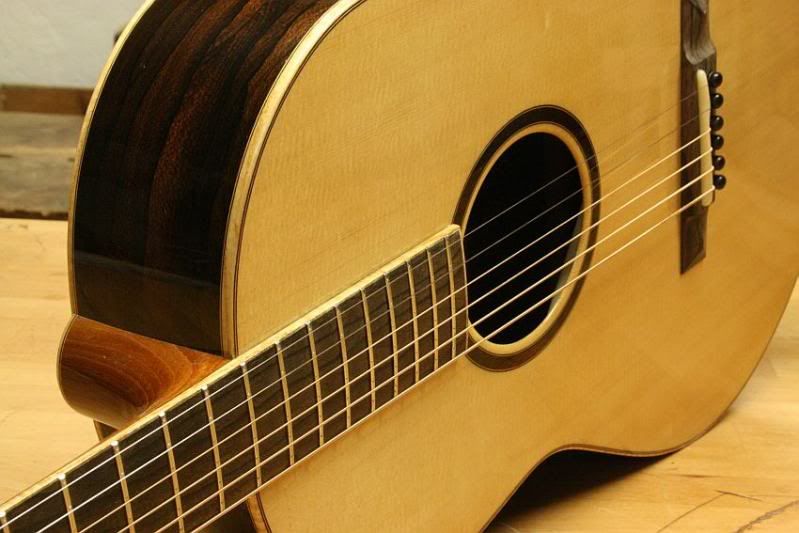

PostPosted: Wed Jan 05, 2011 12:08 am
Offcuts from the sides look good if you use lighter purfs to set them off. This isn't Zircote, but it's dark on dark sides and binding.
